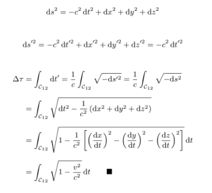

Simply put, the proper time between two events as observed in an unprimed frame is calculated along the timelike worldline between the two events. This implies that the spatial primed spatial coordinates are zero which further implies that only the spatial primed time coordinates remain.
With the above, here are my questions:
On the spacetime diagram, does it mean that the two events will then always lie on the primed time axis? What if in the unprimed frame, the two events are situated such that the same two events do not lie on the primed time axis only? How should the proper time be calculated then?

Yes, I know the formula for calculating proper time but I am confused as to what it means to set the primed spatial coordinates to zero when finding the proper time.
The attached photo is what I am referring to when I mention primed and unprimed coordinates.
That's defining proper time as coordinate time in the primed frame where the object is at rest. And, owing to the invariance of the spacetime interval, proper time is seen to be the length of the spacetime interval in any, arbitrary frame. That's the first line.
The rest is some mathematics to show that it is the integral of ##\frac 1 \gamma## (in any frame).
Note that everything here holds where ##v## is a function of ##t##. And we have:
$$\Delta \tau = \int_c \frac 1 {\gamma(t)} dt$$
So, in your unprimed ##t-x## spacetime diagram, the object can have any timelike motion.
