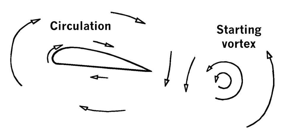

For the wing of a plane, as an example, I think that the circulation around the wing due to faster flow on the top is balanced by the circulation of a vortex which is formed off of the tail. Since the greater speed on the top is necessary for the lift, would that also mean the turbulent flow which has the formation of vortices is necessary?
person123 said:
Summary:: I'm wondering if turbulence is required to produce lift.
Do you mean that some vortices have to form somewhere behind the plane? I would say yes, because the plane accelerates some of the air downwards.
But a plane in an open airmass is one special case. The above doesn't have to be true for all cases of lift, for example for enclosed flow in a pipe.

Assuming that there is still lift, what would be going on (or in any case in which lift is generated with vortices)? If the flow is indeed faster on the top, it seems the fluid has a net angular momentum around any pivot point. In order for angular momentum to be conserved, it seems to me there would have to circulating flow in the opposite direction to counter it.
DrStupid said:
But a vortex is required if lift is explained with the Kutta–Joukowski theorem (for example).
I don't agree. If you're calling the circulation around the wing a "vortex", that isn't what the OP is referring to.
That's the circular flow aroud the airfol the Kutta–Joukowski theorem is based on.
That's the starting vortex.
#19 reather sounds like it exactly what he is referring to.
So would that starting vortex be required?
Erp - yep, sorry I think you're right. Back to the OP:
You're referring to this?:
Yes, it is required. Since it happens after the wing, though, the context is odd. Usually when talking about laminar or turbulent flow people are talking about the flow over the airfoil itself, not what happens in the air behind it. But yes, it is required.
russ_watters said:
Erp - yep, I think you're right. Back to the OP.
Yes, that's exactly what I'm referring to.

I thought that was what was referenced by "circular flow". My understanding is that it isn't actually physically true. That circular flow is just a conceptual model of relative flow velocities once you remove the average flow velocity. I am not convinced the conceptual model is correct at the trailing edge as the 2 streams join there. The real flow is always downstream however. It has been a useful concept historically though.
Also, my understanding is that Bernoulli does not account for the sum total lift measured in practice. It seems to me this and accelerating the flow downwards both contribute to the total lift force.
