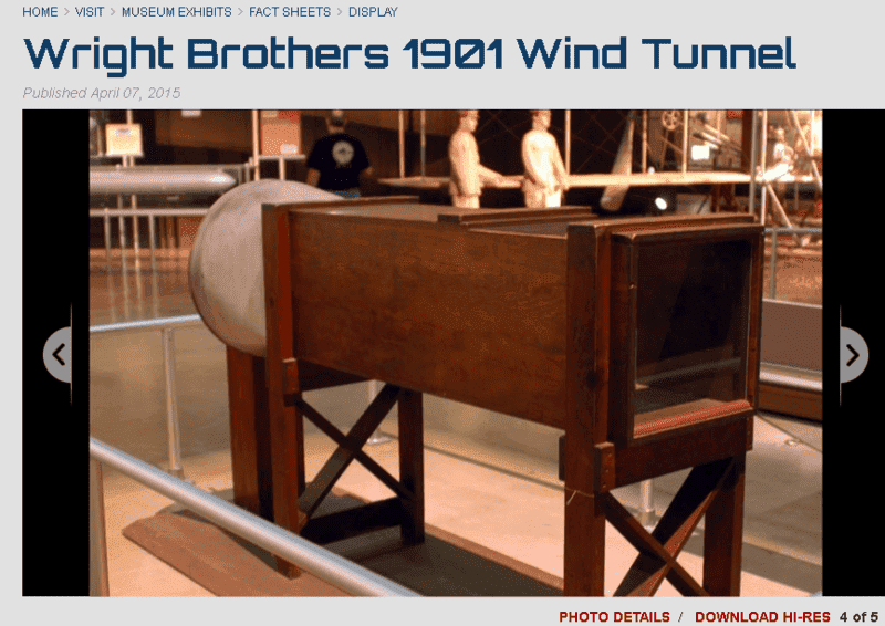

FactChecker said:
A wind tunnel model can be scaled down to as little as 1/100th size.
https://www.nationalmuseum.af.mil/V...icle/198082/wright-brothers-1901-wind-tunnel/
Wooden wind tunnel on display in a museum, with a large cylindrical fan at the left end and a rectangular test section with glass window on the right, mounted on X-braced wooden legs.
  • Wooden wind tunnel on display in a museum, with a large cylindrical fan at the left end and a rectangular test section with glass window on the right, mounted on X-braced wooden legs.
