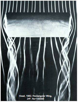

Are vortices needed for lift? Well, Helmholtz second theorem states that a vortex filament cannot end in a fluid. It needs to either end on a surface or form a closed loop. Along the span of a wing there are these 'bound vortices' (as @russ_watters already showed with a picture) since the line integral around an airfoil of the flow tangential to this airfoil*) is not equal to zero (thus there must be vorticity). These bound vortices cannot end in the fluid and thus continue downstream, roll up in two trailing vortices (see picture) and connect through the starting vortex. At least, in potential flow theory where there is no viscosity dissipating these flow features. So I guess vortices are inherently coupled to wings...

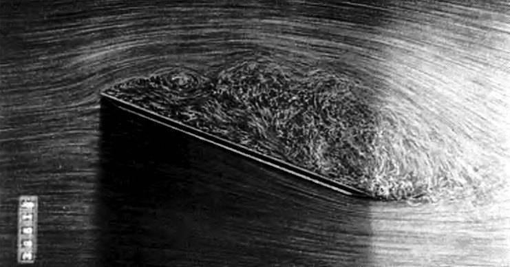

  • The more interesting question about wings is this: why would the flow not separate from the upper side? Why would it follow the surface at all? This has more to do with the Coanda effect. So a plane doesn't fly because of Bernoulli, but because of Coanda! :)
*) ón the airfoil the flow has zero speed due to no-slip. So take the flow just outside of the boundary layer.

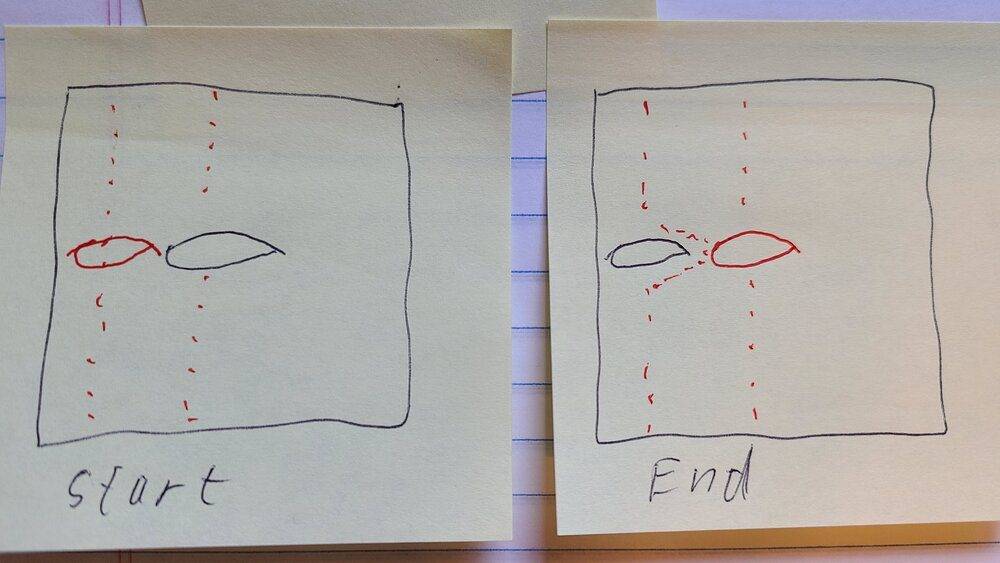

Oh, one last soapbox remark:
The longer path fallacy is indeed a fallacy. The path length doesn't matter since if you would follow two parcels separating at the stagnation point at the leading edge, one taking the upper route, the other the lower one, they do *not* meet at the trailing edge. So the increase in velocity is not explained by the longer path.
It actually has nothing to do with the Coandă effect, which is based on the phenomenon where a jet clinks to a nearby surface. This is not what is occurring around an airplane wing. It is more appropriate when discussing planes whose engines are embedded in the wing and produce a jet of air that blows over the wing. See: Boeing YC-14
That's not "longer path", that's "equal transit time". It is generally true - not a fallacy - that the parcel taking the longer path arrives at the trailing edge first. But it is popular to mix them together inaccurately (including the oft-cited NASA lift explanation for kids). This is part of what I pointed out earlier: overly aggressive debunking of "equal transit time" that takes other concepts down with it.
I can't imagine how confusing it must be for kids to read/see something so obviously true be claimed as false.
So how would you explain why the flow over the top part of the wing stays attached onto the surface? Maybe the original Coandă effect is just about jets, but the reason a jet clings to a surface is comparable to why flow over a wing stays attached. It has a lot to do with the wall normal direction of momentum transport. If there is enough of that the flow clings to the surface, if not you have separation (or the jet does not cling to the surface).
I think the argument usually goes like this: two air parcels arrive at the leading edge, one goes up, the other goes down, when they arrive at the trailing edge the parcel that took the upper route had to cover a longer distance compared to the lower one and therefore the velocity of the upper parcel had to be higher. Higher velocity means lower pressure, hence lift.
So the fallacy is about the two parcels arriving at the same time, and indeed the parcel taking the upper, longer, route is usually earlier at the trailing edge than the other one, which I guess is counter intuitive. I guess you can better call this the "equal transit time" fallacy indeed.
If you thought I was denying that one path is indeed longer than the other, mea culpa, that is not what I intended to say. The idea here was more that you don't need the longer path to generate lift. A flat plate can also generate lift, planes can fly upside down, etc. That's what I meant by calling it the "longer path" fallacy.

Expanding on the last visual I gave (sorry for the multiple late edits...), let's say you have a box of air, with an airfoil in the middle. The airfoil also represents an airfoil-shaped hole in the air, in the center of the box. Now move the airfoil one chord length forward and stop it. Now you've moved the airfoil-shaped hole in the air forward and where that hole was previously, is filled with air. This has to be true because the front wall of the box prevents the air from being pushed forward out of the box, and the hole in the air where the airfoil started can't just be an unsupported vacuum. When the airfoil is in motion, the air in front rushes back to fill the void left behind it.
  • #53
Here's a crude sketch of what I described in Post #52:
The red is the air, arranged in columns, including an airfoil-shaped parcel.

There is effectively no way that an "airfoil shaped parcel" passes over the actual object and the result on the other size is another "airfoil shaped parcel" as you have drawn, especially given that this is in a closed box. The movement of the object will have to push the air in front of it out of the way, which will tend to create two circulating regions in the box: one above the chord of the foil rotating clockwise and one below it rotating counterclockwise. The effects of viscosity dragging air along with the airfoil will reinforce this.
Additionally, the air moving over the top of the airfoil will be moving faster relative to the surface and so the parcel that was originally foil-shaped will leave the trailing edge highly distorted and with nonzero vorticity.

Obviously, my 15 second post-it note sketch is very simplistic, and obviously some of the air that was in front will pass above and some below the airfoil, at least breaking up and distorting the parcel before the air moves behind the airfoil. "Parcel" was probably the wrong word since it tends to be used to describe a very small amount of air, which all moves together (though it does include deformation, and two parcels would probably work). The point of the exercise is that there is a volume occupied by the airfoil in the first sketch, which is then occupied by air in the second, and vice versa, per continuity. It doesn't actually have to be the same molecules of air, but it does have to be the same volume and mass of air (in incompressible flow).
Additionally, the air moving over the top of the airfoil will be moving faster relative to the [bottom?] surface and so the parcel that was originally foil-shaped will leave the trailing edge highly distorted and with nonzero vorticity.
What, you couldn't tell the sketch was of a symmetrical airfoil at zero aoa? :wink: What you are analyzing goes way outside the scope of the thought experiment.
