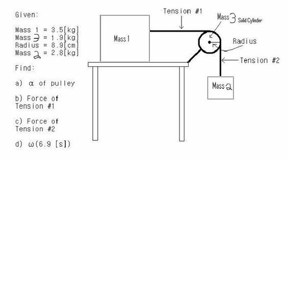

There is a Mass (m1) on a table. The coefficient of friction between the table and m1 is 0.18. The second mass (m2) is hanging, suspended by a string around a pulley (m3) attached to m1. The pulley has a radius (R) and is considered a solid cylinder.
m1=3.5[kg]
m2=2.8[kg]
m3=1.9[kg]
R=0.089[m]
Find:
a) alpha of the pulley
b.)Ft1
c.)Ft2
d.)omega @ (6.9)
I for solid cylinder = (1/2)M2R2
Fnet=ma
Torquenet=I*alpha
alpha=a/R
I drew a torque fbd for the pulley, I found I for the pulley, I drew fbd's for the boxes, got my equations like
m1-->
X) Ft1-Ff=m1a
Y) Fn-Fg=0
Fn=m1g
Ft1=m1a+Ff
Ft1=m1a+Mew*m1*gm2--->
Y) Ft2-Fg=m2(-a)
Ft2=-m2a+m2g
and finally
Torquenet=I*alpha so
Torque1=R*sin(90)*Ft1 = R*Ft1 (k)
Torque2=R*sin(90)*Ft2 = R*Ft2 (-k)
==>R*Ft1-R*Ft2=I*alpha
and alpha= a/R
So
R*(m1a+Mew*m1*g)-R*(-m2a+m2g)=((1/2)M3R2)*(a/R)
That equation just has one uknown --> a
For a i got 3.97[m/s2]
For alpha I am getting like 44 [rads/s2] and others are getting about about 16 [rad/s2]
Can someone spot what, if anything, I'm doing something wrong?EDIT: Sorry for the mistakes..

To make my point more clear: the rotation is clockwise, so the angular rotation is
alpha (-k), not alpha k . This is why we end up with
R*Ft1-R*Ft2=- I*alpha
or
-R*Ft1+R*Ft2= I*alpha

Wait...you have to change the sign of both Ft1 and Ft2 in your torque equation, not just one
Using
R T_2 - R T_1 = \frac{1}{2} m_3 R^2 \frac{a}{R}
and using the same T2 and T1 you had, I find
a = \frac{m_3 g - \mu m_1 g}{m_3/2+m_1 + m_2 }

I mean that the correct equation is
Ft2 - Ft1 = I alpha
Ft2 - Ft1 = I alpha
I don't get how Ft2 is positive now though. Isn't it (-k) direction (so negative in torque equation) and positive in the fbd for m3?
This is what I explained in post number 7
The angular acceleration is clockwise. This means that the angular acceleration is alpha(-k)
So we get
T2 (-k) + T1 (k) = I alpha (-k)
therefore
-T2 + T1 = - I alpha
or
T2 - T1 = I alpha

well, one has to be very careful about the language used. To be exact, alpha itself is always positive (it's the magnitude of the angular acceleration). But the components of the angular acceleration vector may be negative. Note that when I write alpha (-k), the value of alpha itself is positive.
Thank you so much.. So Ft1 will be = -m1a-Mew*m1g
because Ft1 itself is negative in the fbd for m3..
so with the negative Ft1 in the torque equation, that will distribute out and make those two factors positive (in Ft1 itself)
not quite. T1 is positive. And it is given by T1 = m1 a + mu m1 g, as you had initially written.

oh, and the picture for some reason doesn't include the Mew, I apologize, but the written part of the question does.
So I get a=2.93 [m/s2]
alpha=33[rad/s2]
