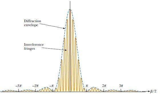

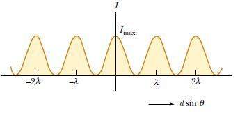

Here is the interference pattern with two slits:
And here is the diffraction pattern with two slits:
As you see, they are not the same; however, the setup of each experiment (according to my understanding) is the same.
The presence of two slits gives rise to interference when you take the superposition of the light that comes out of both slits. That interference is due to the difference in the path length that the light has to travel to the observation point with regard to the two slits. The interference resulting from this path length difference is periodic and is shown in your first picture. However, the light emanating from a slit is diffracted. This means that the brightness of the light emanating from a single slit decreases as you increase the angle. This is the diffraction envelope. So the actual pattern of the incident light from two slits is going to be the interference pattern scaled by the diffraction envelope as you see in your second picture.
This is a good explanation, thank you, so what is really obtained on the screen is like the second picture. Am I right?
The first picture needs slits with a width similar to the wavelength of light (or a very large double-slit separation and a microscope). The second picture is more realistic for real double slits.
Here's the two-slit "diffraction" pattern from a previous post:
If you close or block one slit, you would see (only) the pattern indicated by the dashed line, but with lower overall intensity because only half as much light enters one slit versus two slits. The small-scale variations (solid line) disappear.
If you gradually reduce the widths of the two slits, while keeping them the same distance apart (center-to-center), the pattern indicated by the dashed line (envelope) spreads out while the small-scale variations maintain the same width. Eventually the central maximum of the envelope "fills the field of view" so to speak, and the amplitude of the small-scale variations is nearly constant. The overall amplitude of the pattern decreases because there is less light going through the slits.
If you move the slits further apart, while keeping them the same width, the small-scale variations (solid line) become narrower, but the dashed-line envelope remains the same. If you move the slits closer together, the small-scale variations become wider, but again the envelope remains the same. When the two slits get close enough to merge, you end up with a single-slit pattern.

You need to interpret this pair of pictures carefully in order not to get the wrong idea - they have different horizontal scales. It is unfortunate that the coarse variations appear about the same in the two pictures. The variations on the first picture is for the two (infinitely thin) slits but these correspond to the fine variations in the second picture. In the second picture, rapid variations correspond to wide (slit) spacing, slower variations correspond to a narrow aperture (slit width).
