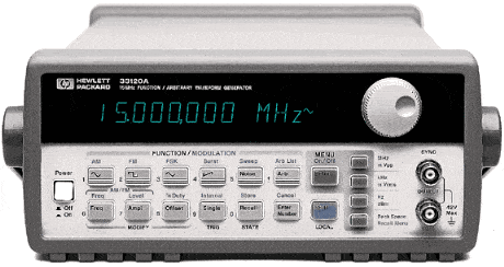

This is the AFG that I use most of the time, the HP/Agilent 33120A:
http://webhw.unca.edu/bennett_phys222/Content/labs/oscope/images/hp33120a.gif
berkeman said:
Ah, I think you're right, Dave. I use Arbitrary Function Generators often, but was confused when the OP mixed the term in with "oscilloscope":
Na. Acoustic waveguide
Ah, huh! That does sound more likely, but I suppose you can use either in an ultrasonic imaging application. Thanks for the link. :-)
