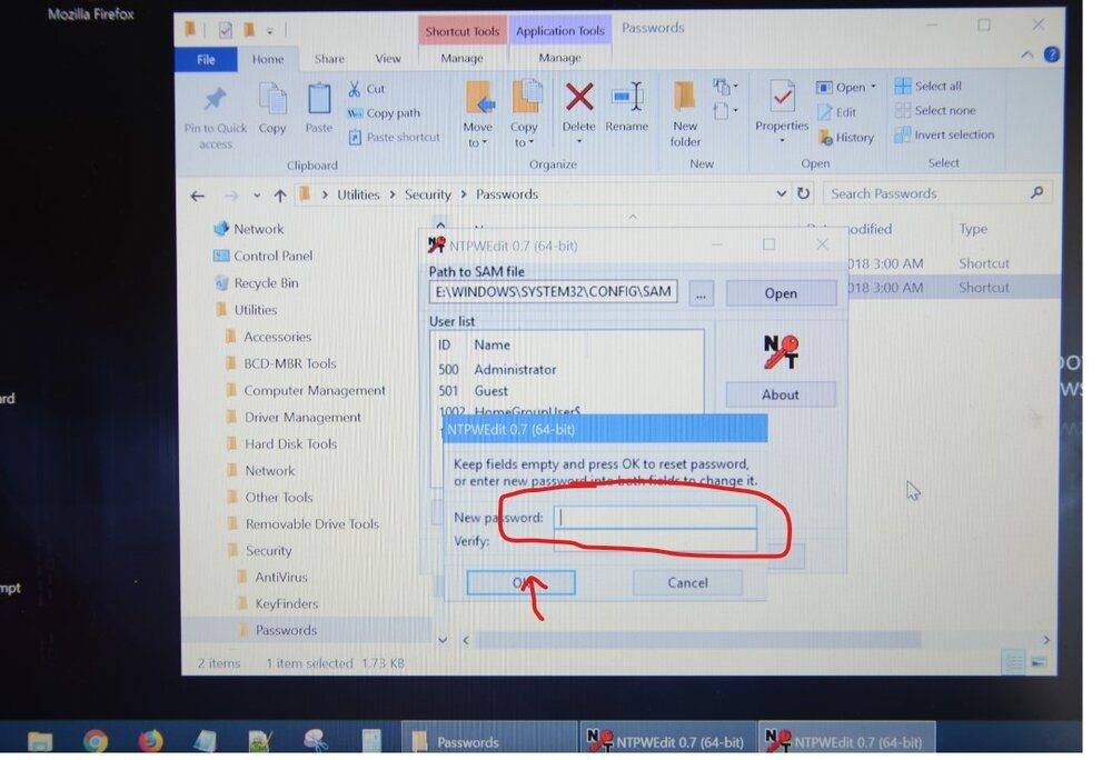

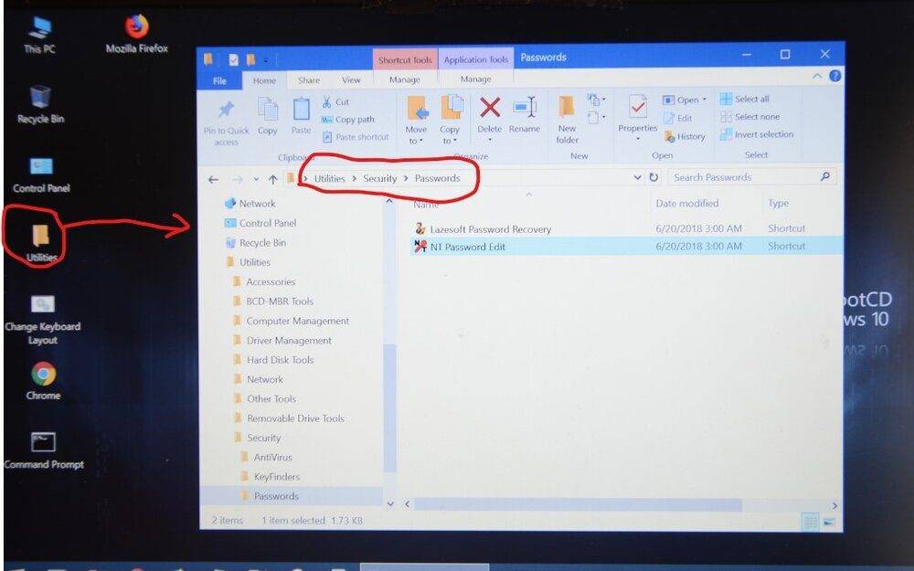

Good morning, I read through the turbofuture.com link, it is very different from the desktop I have, as you can see in the picture 10. There is no "WRENCH" Icon on my desktop as you can see. But I looked around, in the UTILITIES folder circled in RED, UTILITIES->Security->Passwords this is the screen I got as shown.

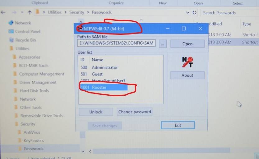

I went into NT Password Edit as shown in 11, There is a user name "Rooster" which is my user name for my laptop where it want me to put in the password. I highlighted Rooster and click open and got into page shown in 12. I put in my new password and click SAVE CHANGES. Is this it? That I change my password already?
I am afraid the next step is to power down the computer and try!?:):nb) ! I got in so far, don't want to lose it!
I know now that I get the Command Prompt, there got to be a way now. Can you teach me how to use the Command Prompt to do this?
Thanks
Alan

I gather my courage, unplugged the USB ( Hiren's), restarted the computer and.......
IT WORKS!
:partytime::partytime:👍👍
Thanks you so much for your help Sysprog. I really thought this computer is a goner.
How do I delete whatever Hiren programs and files in the computer? Or when I unplug the USB, it's gone?
Again, thank you so much to have the patience to hold my hand and guide me through this painful process.
Alan
  • #63
Yaaaayyy!
Hirens doesn't leave any stuff around ##-## just unplug the USB device ##-## most of the utilities will run without having to boot from the USB device ##-## you can just plug it in while you're running your normal OS, and navigate to the utilities from there ##-## please be careful ##-## some of those very helpful utilities can have drastic effects if they are accidentally misused.
To eliminate the Windows login password requirement, you can run the NT Password Edit again and just hit Enter in the new password and confirmation fields; similarly, you can do that from the BIOS Settings Update to eliminate the BIOS password ##-## if you would like assistance with that, please post again.
