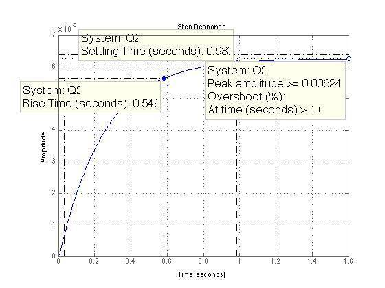

Im going to have a go assuming the nominator of the transfer function is 1.
I can't properly explain how to do this. But let me show a similar example:
Putting this code in Matlab
EDU>> Q2 = tf ([5],[1 204 800])
figure(99); bode(Q2)
figure(100); step(Q2)
Generates this
There are buttons for the parameters you asked for.
So from what I know the solutions to the denominator of the quadratic are the roots.
And the roots give you the location of the poles.
So if you can figure out what the transfer function is, I am happy to re-plot for you.
Unfortunately I don't have a fuller answer for you: I am studying Control Systems 1 at the moment myself. Hopefully by the time I get to Control Systems 2 I can answer this properly :)
p.s. to get the Fourier transform we substitute s=jw into the roots of the equation
\frac{1}{s{}^{\wedge}2+204 s+800}=\frac{1}{(s+200)(s+4)}
