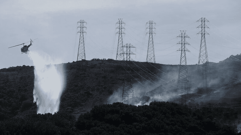

But it's not the really high TLs that need to get buried, right? It would be lines that are at tree-height that are the problem, I believe. @anorlunda is that right?
These pilots are heroes, IMO. Can you imagine the updrafts, etc. they must experience?
They're all heroes, in my mind. The firefighters on the ground slog up and down steep terrain, working axes and shovels in the heat.
