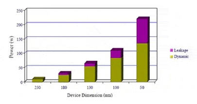

leright said:
there is some leakage though particularly due to quantum tunneling for modern circuits, so static power dissipation is still there
I think you are underestimating the static current. And this isn't showing 14nm,
Which part of my comment made you think that? I am just saying that dynamic power consumption is one of the primary causes of power consumption and that is obviously related to clock frequency.
I'm saying that in modern processes static power dominates, that is, is the primary cause.
Indeed. I don't debate this fact.
