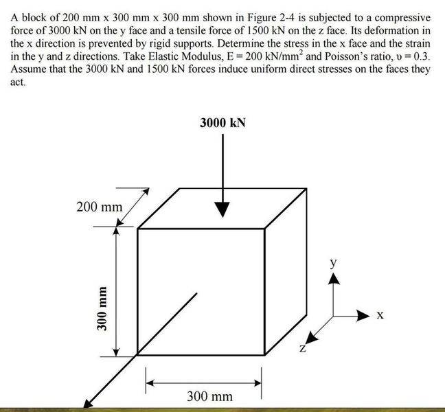

Hi all,
Having some trouble getting the final answer on the question below, the fact that the cube doesn't have a force in the x direction is throwing me off. Once I fine the force(??) in the x-direction, I can just use the generalized Hooke's law to obtain strain? Any help is appreciated.
Diagram of a cube labelled 200 mm, 300 mm and 300 mm, with a downward arrow marked 3000 kN on its top y face and x, y and z axes drawn at the bottom right.

In the block is constrained in the x-direction, what is the strain in the x-direction? What does your first equation give you in this case?
Chet
So I am assuming Sigma(x) = 0, therefore, Strain(x) = -1.00005 x10^-4
However the question says to find the stress in the x-direction, which I have taken as 0?
Or, do I sub Epsilon(x) as 0 and therefore would be able to find Sigma(x) from the first equation? After second thought I think this is correct due to 0 deformation in the x direction hence strain is 0?

How can you say that the strain in the x direction is not zero, when the problem statement says that strain in the x direction is zero? What does the word "constrained" mean to you?
