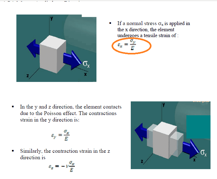

the tensile force is applied at x direction to the cube , the cube will decrease in size in y and z direction , right ?
according to notes,
the strain in x direction εx = σxy/ E , where σy = normal stress in y direction , [/B]
Which is correct ? I think the εx = σx / E make sense , so i think it's correct , because the force is applied in x direction .
Correct me if i am wrong
  • Two slide panels on a stress-strain topic. Top left: a block with a normal stress σx pulling along x, with the y and z axes marked. Top right: text and the formula εx = σy/E, circled in orange. Bottom left: formulas εy = σx/E and εz = -νσx/E. Bottom right: a deformed block showing the Poisson contraction in y and z.
Get rid of this horrible book. There are typos in 2 out of the 3 equations it presents on just this single page. I will no longer answer any questions about the information in this book.
