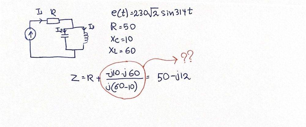

Special One
32
I have been trying to understand it but I couldn't
can anyone illustrate with deeper answer?

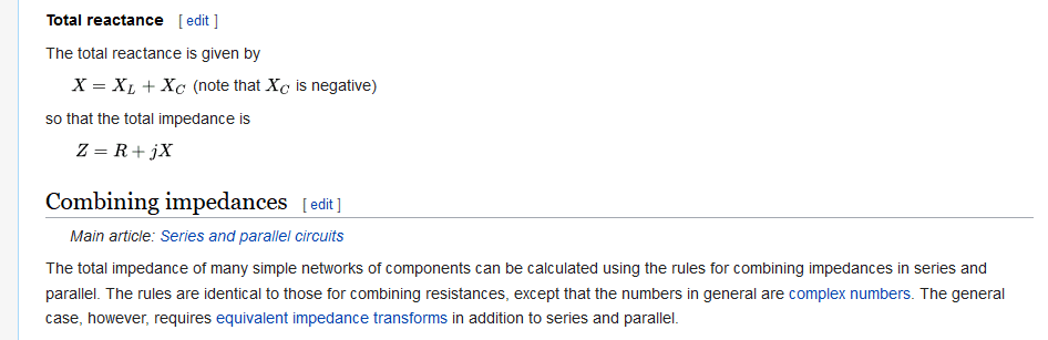

The LC network is in series with R, so work out its total reactance first.
As with resistors in parallel, reactances use the same formula, but with either + or - signs.
So 1/X = 1/XL - 1/Xc
1/X = 1/10 - 1/60
X = 10 x 60 / (10 -60) = 600/-50 = -12
In other words, -j12.
Now add this to R,
Z = R + X
Z = 50 - j12
If you have a reactance, rather than a resistance, you put j infront. It means that the current in the component is 90 degrees to the voltage.
Special One said:
But I still didn’t get how j appeared!?
I sympathize. ##L, X=\omega L, j\omega L, jX, \vec Z## are all notations for the same thing. Why so many? Because practitioners find it convenient. You'll just have to learn them all and live with it.

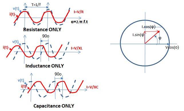

One could measure voltage and current with an a.c.ammetter. Then you'll get an average voltage named "rms" [root mean square].
Actually the alternative instant current [a.c.] value changes all the time very fast in a cyclic way.
From maxim to maxim [peak to peak] values the time is very short T=1/60=0.0167 sec[16.7 millisecond] or 1/50=0.02 sec.
An oscilloscope can measure that[See the link] and we can represent the measurement results on a paper so we get a sinusoidal wave.
https://en.wikipedia.org/wiki/Oscilloscope
If the voltage is applied on a [pure] resistance a current will pass through the resistance and the current wave will be the same as the voltage wave only at a different scale.
Not the same phenomenon occurs if instead of a resistance we have a coil that means an inductive reactance: the current wave will lag the voltage wave with 0.0041 sec[90o or π/2 radians].
If instead of resistance we have a capacitor the current will lead the voltage by 90o.
One may represent this wave on a circle and since α=ω.t changes with t always we may think the circle rotates with ω radians/sec. Let's sit on the circle plane [in the same way we stand on the rotated Earth and we think the Earth is fixed and does not rotate].Then v(t)=√2.Vrms. Let's represent -for our convenience- on a scale 1/√2.Then v(t)=Vrms=V.
The line representing the voltage or current in the above circle we call it phasor [and some time vector].
We may use for V the angle 0 since V.cos(o)=V.
If i(t) angle will be φ<>o then the actual part of the current will be I*cos(φ) and in case of pure resistance
when φ=0 i(t)=I.
I.sin(φ) it does not represent a real part of the current but a "parasite" one.
If we use the factor j=√-1 -which does not exist actually-we may assemble an imaginary expression j.sin(φ)
So we can consider y ordinate as imaginary one while abscissa x as the real [as voltage ].
i(φ)=I.cos(φ)+j.I.sin(φ)
If φ=0 i(φ)=I
If φ=-90o i(φ)=-j.I.sin(φ)
If φ=+90o i(φ)=+j.I.sin(φ)
If we multiply I^2 by R we get an actual power which we can measured with a wattmeter.
If we divide V by XL=2.π.f.L where f=supply system frequency and L the circuit inductance, or XC=1/(2.π.f.C) we get the current [IL or IC].But IL^2.XL [or IC^2.XC] it cannot be measured on a wattmeter. It is not a real power but a "reactive power".
If we combine a resistance and an inductance or capacitor we get a mixed current where tangent(φ)=XL/R [or XC/R].
