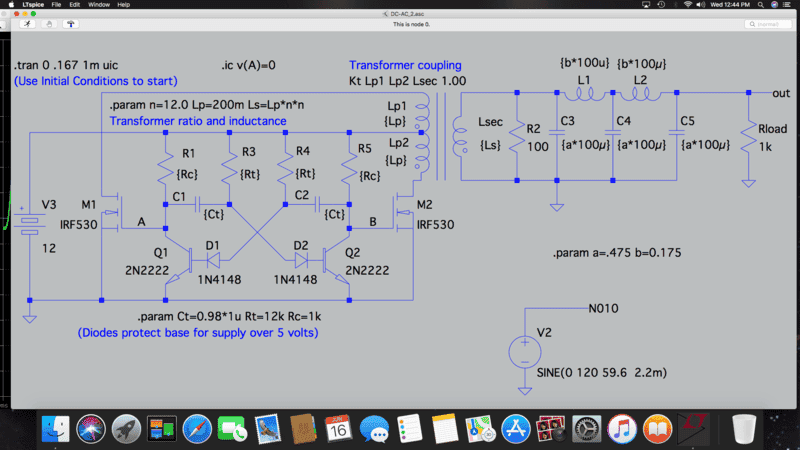

I need help understanding how to model an inverter circuit and what to expect given a circuit diagram.
As a step to a solar powered battery backup system I wish to get a better grasp on how DC to AC inverters work. This circuit shown below is a 12V DC to 120V AC inverter. I am doing ltspice simulations first and I am working from a circuit diagram included below I found online here;
https://www.elprocus.com/dc-to-ac-converter-circuit-working-applications/
It is easy to spice this up in ltspice except for the transformer part. I do not understand how to model the center tap and if the transformer is just inductors or if there are other components. Also, I tried to simulate just the 12V DC to 12V AC without the transformer but get nonsensical results.
1) Can I model just 12V DC to 12V AC without the transformer or is the transformer necessary to the circuit?
2) Will this circuit give a sine wave or a modified sine wave?
3) I need help understanding and modeling the center tap transformer part.
Schematic of a 12V DC to AC inverter circuit with a center-tapped transformer, two transistors, diodes and capacitors, with a 12V battery on the left and a 120V AC output on the right.
I'd like to understand how to get a sine wave with only transistor, caps, diodes, inductors and not using IC's if possible. Thanks for any help or advice!

The transformer symbol in the diagram has been rotated by 90° which makes it really confusing.
The design of a transformer is described in the LTspice FAQ documentation, but it is probably easier to modify your circuit. If you attach your Ltspice filename.asc file to a post we can edit it and return it, hopefully working. Since it is an ascii text file internally, first change it's extension to filename.asc.txt
In a nutshell, place three inductors; primary Lp1, Lp2 and secondary Lsec. Couple them by placing a K command anywhere on the schematic; Kt Lp1 Lp2 Lsec 1.000 ; Notice they now have dots showing polarity.
Set the inductance to specify the turns ratio. Primary side voltage to secondary voltage here will be about 1 : 10; Because L is proportional to n², (turns squared), give Lsec an inductance of 10² = 100 times the Lp inductance. Transformer current will be too high if L is too low.

Thanks. The entire circuit as drawn is confusing. The drains of the power mosfets go to the transformer but I assume the wire does not intersect the 12V battery but they don't make that clear. Then, it's not clear how or why the center tap connects to the 12V DC. Here is my netlist for ltspice. Thanks for any help.
Your Vibrator2.txt file is a generic spice file, not an LTspice schematic.asc text file.
It should contain the “wire” commands that draw the schematic.
Attached are example .asc and .plt files that demonstrate a centre tapped transformer.
Remove the .txt extensions to get the LTspice schematic to run and plot.

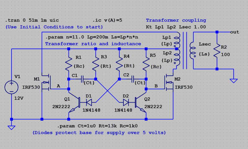

Here is the cleaned up circuit with the transformer untangled.
I have parameterised most values to make juggling timing and output voltage easier.
The frequency is set by Ct and Rt, (to about 55 Hz).
Given the transformer turns ratio, n=11.0; and the primary inductance, Lp=200mH, Ls=Lp·n² is then computed.
The two diodes protect the transistor base-emitter junctions from negative voltage breakdown, which will occur in the astable for supply voltages over about 5 volts.
A symmetrical circuit simulation may be too well balanced numerically to start cleanly. By specifying an initial condition the simulation starts reliably. The uic flag on the .tran command is needed to use the specified .IC V(A)=5 volts.
Here is the schematic. Attached is the LTspice.asc text file.
LTspice schematic of a 12V push-pull inverter: two IRF530 MOSFETs drive a center-tapped transformer primary (Lp1, Lp2) to a secondary Lsec feeding R2 100 ohm to out; cross-coupled 2N2222 transistors Q1 and Q2 with 1N4148 diodes and 1u0 capacitors form the astable oscillator.

Thank you very much! Sorry I sent the txt file. I didn't notice you wanted xxx.asc.txt. I shall run this today.
I ran it and now I understand a few things better. I see that the transformer is integral to the circuit, not just to step up the voltage but to get to AC in the first place and also that this circuit gives a modified sine wave and not a pure sine wave. As a result, it would not work for my solar inverter. Also the center tap hookup makes sense to me now. Next, I'm going to explore pure sine wave inverters. Thanks for the help Baluncore! I appreciate it very much.

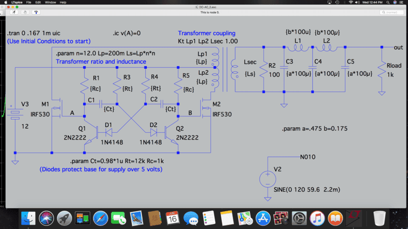

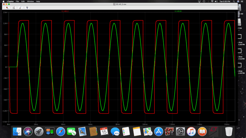

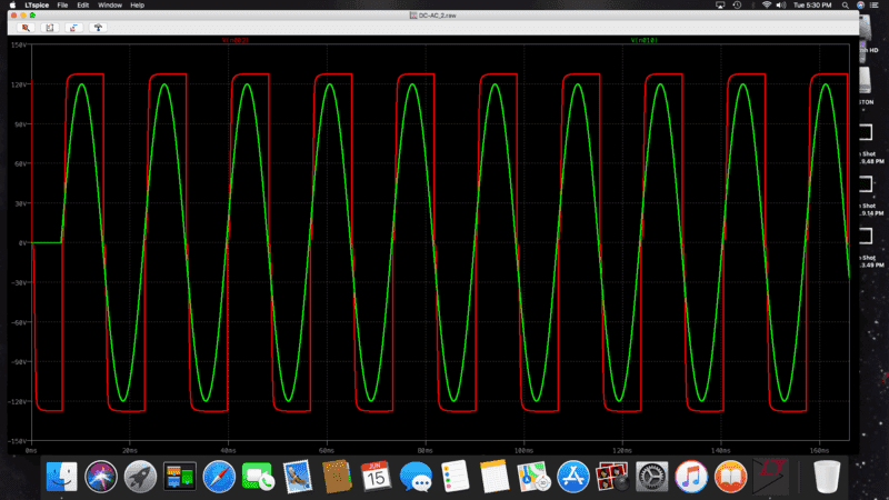

I added a filter to the output and turned the modified sine wave (more like a square wave) into a fairly reasonable sine wave but the current out of the 12V DC source spiked some tenfold. I wonder if its possible to buffer the output from the input so I can change the waveform shape from pulse to sine wave without causing this large current spike? Or, change the waveform shape before it gets to the transformer? Thanks.
LTspice oscilloscope plot of a red square-wave output and a green sine-wave output over about 16 ms, with the voltage axis ranging from -154V to 154V.

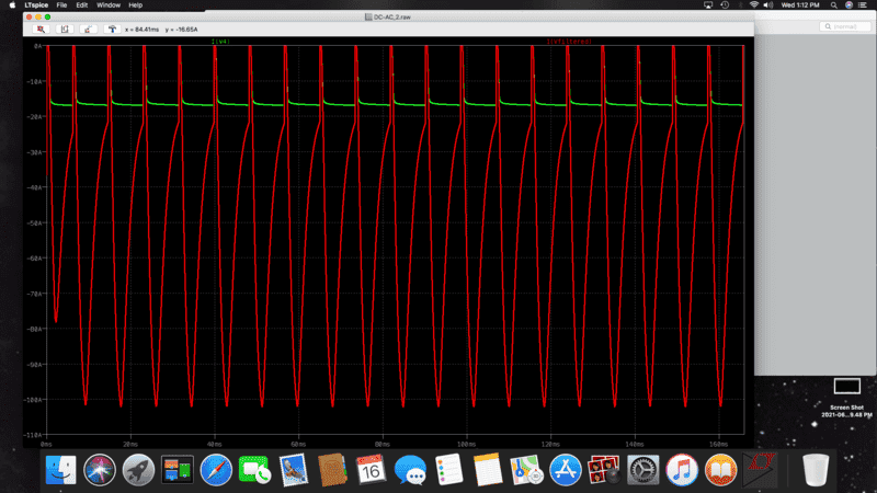

LTspice simulation plot of current against time showing a red trace of repeated sharp negative current spikes reaching about -100A and a green trace near -17A, with the time axis running from 0ms to 160ms.
LTspice schematic of a push-pull oscillator driving a transformer, with IRF530 MOSFETs M1 and M2, 2N2222 transistors Q1 and Q2, 1N4148 diodes D1 and D2, and a 12 V source V3, followed by an LC low-pass filter with L1, L2, C3, C4, C5 and load Rload 1k.
bob012345 said:

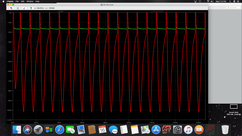

I added a filter to the output and turned the modified sine wave (more like a square wave) into a fairly reasonable sine wave but the current out of the 12V DC source spiked some tenfold. I wonder if its possible to buffer the output from the input so I can change the waveform shape from pulse to sine wave without causing this large current spike? Or, change the waveform shape before it gets to the transformer? Thanks.View attachment 284557View attachment 284556View attachment 284555
Try removing C3 from your filter.
Thanks, I just tried that but the current still spikes about the same.
Also, I really need to model the 12V source as a battery which in my case is about 10Ah with a maximum
current of around 20A.
OK, then bigger inductor values and smaller capacitor values.

@bob012345
Screen shots are big, hard to read, and can contain hidden circuit values such as parasitic R, L and C.
LTspice has pull down menu 'Tools', select 'Copy bitmap to Clipboard'. For a small readable file paste the bitmap into an image file, crop, and save as .jpg or .png.
Also, attach to your post the schematic.asc file renamed as schematic.asc.txt That way we get the circuit with any hidden values that do not display on the schematic.
There are other inverter topologies that will produce a sinewave, and be less load sensitive.
Thanks. Here is the schematic which I names inverter.asc.txt

One problem converting square wave to sine wave with output LC 'T' filters to is that they make an impedance matching network, so the output voltage becomes load dependent. Also, the output filter needs to be selective to the same frequency as the fundamental that was generated by the bi-stable R&C time constant. The sensible way to get the two frequencies to track is to dispense with the bi-stable R&C timing, and take the output of the tuned circuit as feedback to control the power transistors. That is a different topology.
