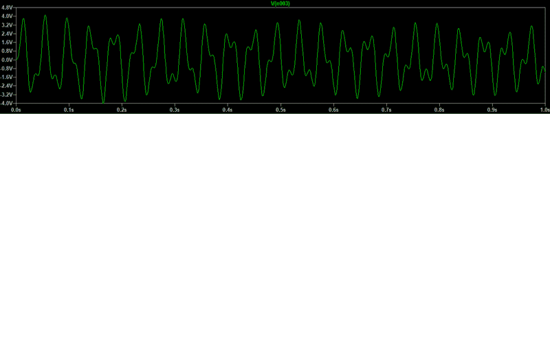

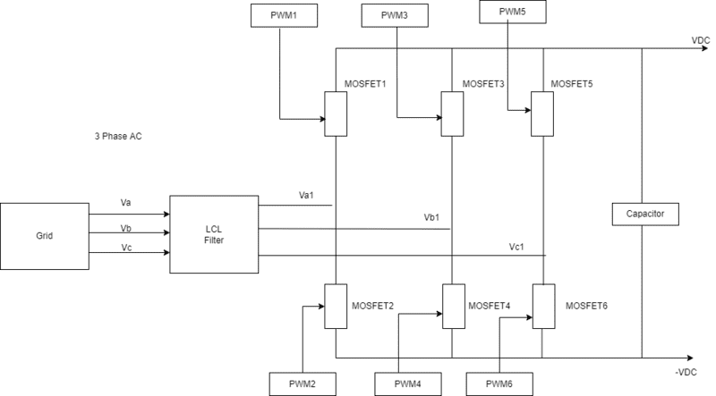

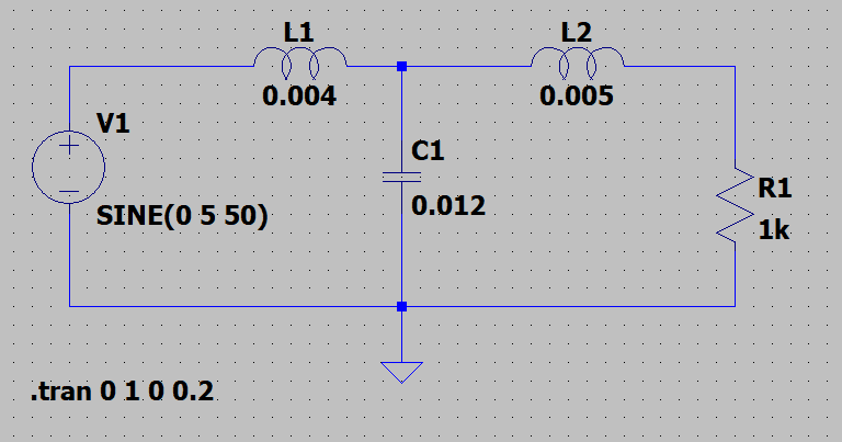

I am trying to simulate the active converter, I have seen in you tube video the output of the grid 3 phase voltage is given to LCL filter, the output of the LCL filter is then given to the half bridge section. I assume that the output of the LCL filter is a DC instead of the sine wave, as it is given to the half bridge section, is my understanding correct? Or sine wave can also be given to half bridge? VDC will be the output i hope, that is what i am trying to achieve DC from AC. Please advise. I also tried to simulate a simple LCL circuit in Ltspice, the output as shown when a sine wave of 50Hz given. I am bit confused with Inverter and converter, where is the difference happening, both use H bridge?

  • LTspice schematic of an LCL filter: sine voltage source V1 (SINE(0 5 50)) feeds series inductor L1 (0.004), shunt capacitor C1 (0.012) to ground, series inductor L2 (0.005), and load resistor R1 (1k); simulation command .tran 0 1 0 0.2.

The 'T' filter is designed to prevent switching noise generated by the H-bridge from reaching the grid, and so causing EM interference.
I am surprised that the values for the L and C components are so large. It seems to be tuned to pass energy at 23 Hz. How did you select those values?
Can you please give a link to the video?
Sorry the LT spice model is created by me to understand the circuit, to verify the output of the filter, i have chosen random values of inductor and capacitor, the video is

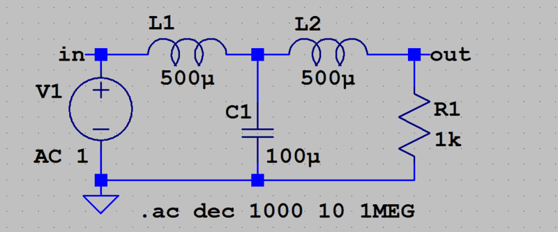

From the video, the values of L1 and L2 are 500 uH, C1 is 100 uF.

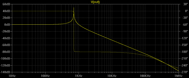

This shows AC analysis of the symmetrical T filter. It is designed to allow 50 Hz to pass, but to stop HF noise from reaching the 3PH supply.
The way the AC to DC converter is drawn is very confusing.
It takes 415 V, 50 Hz, 3PH AC and switches it into the DC storage capacitor.

Bode plot of V(out) from a circuit simulator: gain in dB on the left axis and phase in degrees on the right, against frequency from 10 Hz to 1 MHz, showing a sharp resonant peak near 700 Hz and roll-off above it.

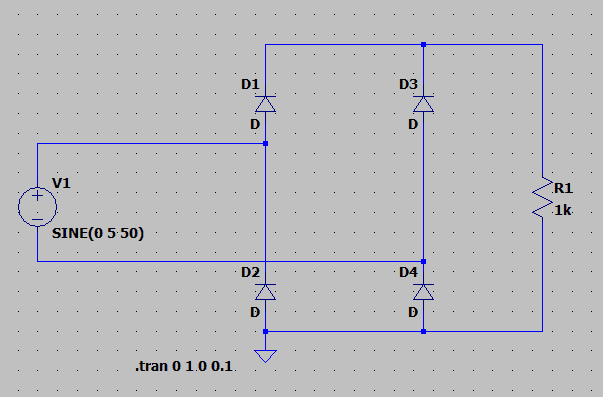

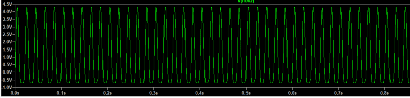

I am trying to learn the algorithm of Active converter, which i have to execute in Matlab, as a first step i saw a circuit and drawn in Ltspice, the output will be DC voltage with ripples, in the book the circuit is controlled using thyristor, i have redrawn using diodes. My initial confusion is, giving the negative portion of the sine wave to the bridge which is different from the ground. When i plot the output of the sine wave i get the below result, with the negative portion swing is reduced. But how do i understand the sine wave and ground different?
Reduce the load resistance from 1k to 100R. Then you will see the flat base.
Two diodes in the bridge must turn on before conduction occurs. That explains the missing 1.5 volts. Each is dropping Vpn=0.75 volt. Increase the voltage to 50 Vpk, and the 2*Vpn will be a minor problem.
Note that LTspice specifies the peak voltage of the sine wave, not the RMS.

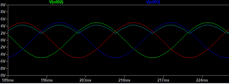

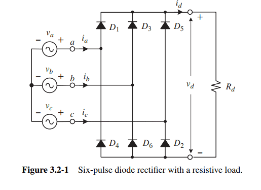

Surely i will try this, but before that i found another simple circuit compared to the above, with all the AC phases grounded, I want to understand which bottom diodes will be ON, it is very confusing.
Circuit schematic of a six-pulse diode rectifier with a resistive load: three AC voltage sources va, vb, vc feed diodes D1 to D6 arranged in top and bottom rows, output current id, voltage vd across load Rd.
I also simulated in the LTspice, my explanation is something like this when Va is Positive and greater than Vb and Vc, D1 is ON, D4 is OFF. Could you please explain me which of the bottom diodes will be ON in simple terms.
Plot of three sinusoidal waveforms over one cycle: two sine curves in green and cyan near the top and a blue curve that dips and rises, with a red curve crossing the blue one.
LTspice plot of three phase voltages V(n002) green, red and blue traces, with cyan and white traces, over 189 ms to 224 ms, sinusoidal waves offset from each other by about 120 degrees, ranging roughly from -6V to 6V.
The highest diode that will be conducting will be that on the most positive phase.
The lowest diode that will be conducting will be that on the most negative phase.
Let's just assume that D1 and D6 are conducting at time ##t_{16}##. That will create a voltage at the output of ##v_a(t_{16}) - v_b(t_{16})## let's call this ##v_{ab}##; this is pretending that the diodes don't drop any voltage when they're on, a convenient, but wrong assumption. For this to be correct, we must have ##v_{ab}## be greater than all of the other combinations (##v_{bc}, v_{ca}, v_{ba}, v_{cb}, v_{ac}##). Otherwise a different diode pair would conduct.
So, it's not the most positive or negative phase (wrt neutral) that determines the switching, it's the greatest phase difference. For example: when is the maximum value of ##sin(\omega t) - sin(\omega t +\frac{2\pi}{3})##? It turns out this isn't at ##\omega t=\frac{\pi}{2}## when ##sin(\omega t)## is maximum, it happens at ##\omega t=\frac{2\pi}{3}## (I think, you should probably check my math).
PS: Of course the switching doesn't happen at the maximum. For that you need to look for when the line to line voltages are equal, like ##v_{ab} = v_{bc}## etc.

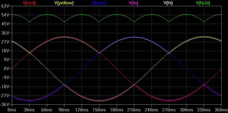

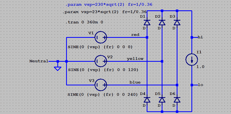

LTspice schematic of a three-phase six-diode bridge rectifier fed by three sinusoidal voltage sources (red, yellow, blue) referenced to Neutral, with a current source I1 on the hi and lo DC output rails.
Multiply voltage scale by 10. Interpret time in ms as degrees.
Simulator plot of six voltage waveforms against time from 0 to 360 ms: V(red) and V(yellow) cross zero near 30 and 90 ms; V(blue) and V(hi) rise to about 32 V near 210 ms; V(lo) and V(hi,lo) are shown as green rectified dips near 54 V.

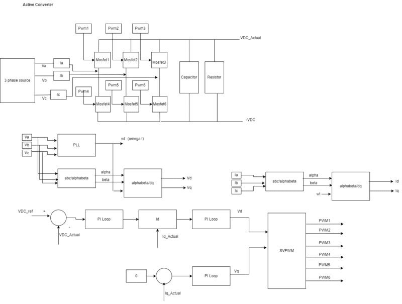

Going through several websites and documents arrived at the following flow for the active converter. I have used the SVPWM technique to control the VDC voltage. Request to please provide review comments to update, updated the simulation in Matlab but some compile errors in svpwm block, i will rectify then i can share the results.

I do not understand how you can use MOSFETs in that topology to regulate the output voltage. The source must be connected to an extreme voltage that the drain never crosses, or the substrate diode will conduct.
I do not understand much but I have seen IGBTs being used, that is what is meant to use in place of MOSFETs?
An IGBT is a BJT with a control MOSFET connected between the base and collector. The IGBT has the same reverse conduction problem as the MOSFET.

You need to produce a circuit diagram that shows the actual components between the 3PH and the DC output. Then I will know which diode you are referring to, and how it is connected relative to the 3PH and DC.
It is possible that the MOSFET substrate diodes are being used with the second inductor of the T-filter for soft commutation of the converter.

Yes, I would expect they will commutate OK provided the controller doesn't do something wrong.

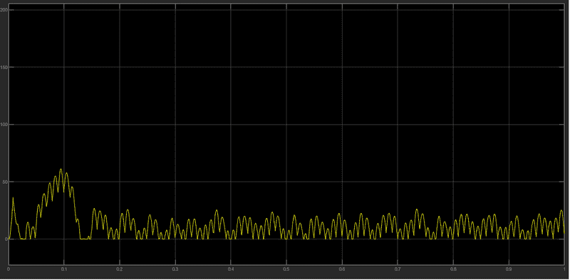

After simulation the results looks like this, the DC voltage does not regulate it goes to 0 and the set DC voltage is 800V. Any suggestions where the mistake could be?
  • Simulation plot of a yellow waveform against a black background with grid lines; the y-axis runs from 0 to about 200 and the x-axis from 0 to 1. A broad hump peaks near 60 around x = 0.1, then the trace settles into low, irregular ripple between about 0 and 25 for the rest of the range.
It is probably in the lack of documentation.
We have no idea what code you are running, or what happens in those rectangular blocks.
If you produced a complete circuit diagram of one of the MOSFET switches, that might explain everything.
If you could please install MATLAB trial version available, i can share the simulink model to open it. The rectangular boxes are directly the library components of the MATLAB simulink.

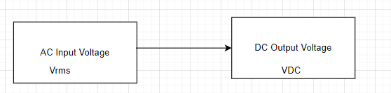

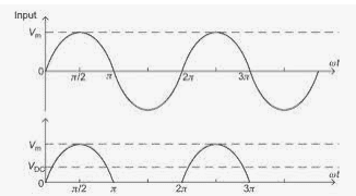

Ok, few clarifications i want to calculate the max half wave / full wave rectifier DC output voltage from the input sine wave
Two stacked graphs of voltage against wt: the top shows a sine wave labelled Input with peaks at Vm, the bottom shows its half-wave rectified output with peaks at Vm and a dashed DC level labelled VDC, both with markers at pi/2, pi, 2pi and 3pi.
If the input sine wave is
i=##A\sin(\omega t)##;
Dc_output = ##\int^{\frac{\pi}{\omega}}_{0} A\sin(\omega t)##
=##\frac{A}{\omega}[-\cos(\omega t)]^{\frac{\pi}{\omega}}_{0}##
=##\frac{2\sqrt2A_{RMS}} {\omega}##
But when see the answer it does not depend on the frequency, the answer is ##\frac{2\sqrt2A_{RMS}}{\pi}##.
Please help me to find how ##\pi## is arrived.

Wait, what? Is that really your question. It happens ALL THE TIME in sinusoidal stuff.
Sorry, anyway...
The DC value of a waveform means the average value. The waveform is repetitive, so as long as you average over complete cycles, the frequency doesn't matter. The average of the first cycle is the same as the average of the second cycle, which is the same as the average of the first and second cycles.
Like this:
What is the average value of the numbers 4, 8, 2, and 6?
What is the average value of the numbers 4, 8, 2, 6, 4, 8, 2, and 6?
What is the average value of the numbers 4, 8, 2, 6, 4, 8, 2, 6, 4, 8, 2, and 6?
What is the average value of the numbers 4, 8, 2, 6, 4, 8, 2, 6, 4, 8, 2, 6, 4, 8, 2, and 6?
Does the average value depend on how many cycles I ask about?
Ok thank you now i understand the answer shall be divided by the width of 1 cycle, ##\frac{\pi} {\omega}##.
Hence the answer will be ##\frac{2\sqrt2 A_{RMS}} {\pi}##. Thank you very much.
For a sinewave, the average voltage is not the integral, but the Root Mean Square.
For; v = A * Sin(...), the average voltage will be; Vrms = A / √2 .

Sorry, I know it's semantics, but..
The average value of a sine wave is zero. The RMS value is the RMS value, not the average. The world will be a better place if we can all stick with ##Avg(f(t)) = \frac{1}{T} \int_0^T f(t) \,dt## . It's a pretty good definition that has served us all well.
