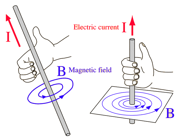

http://hyperphysics.phy-astr.gsu.edu/hbase/magnetic/magcur.html"
A picture is worth a 1000 words. In this case anyway.
I know this.
That doesn't answer my question.
To say that B will circle the wire - does it imply that the iron filings will actually start moving in circles around the wire? Aka will they actually receive a constant angular force? Or will they simple orient themselves in a circular fashion and sit there?
Thanks,
JoAr
They will line up in a circular pattern as represented by the blue arrows. With a constant current in the conductor, the fillings will just arrange in that pattern and set there. Notice that each filling will actually be magnetize with it polarization (north/south) determined by use the "right hand thumb rule" as illustrated.
