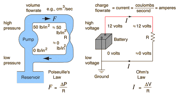

okay, here i am again requesting you to help me.:smile:
1:-- on a circuit diagram ground symbols are like water tanks. all tanks having water at the same level so that connecting the tanks does not make the water flow one tank to another. is ground symbols always taken to be at 0V?
2:-- in case of a battery negative terminal is taken to be at 0V, hence it is a ground in itself. but in the case of AC current, can we use 'circuit' ground symbols? AC only stays at 0V. i mea it cross 0V points twice if we start measuring the cycle from the one peak to next peak. perhaps in case of AC 'circuit' ground symbols mean that voltage and polarity there will be the same no matter what.
tell me please. many thanks.
cheers:smile:

I don't like using the "water analogy" for circuit analysis, but it can be a learning tool. Take a look at the link below about this:
http://hyperphysics.phy-astr.gsu.edu/hbase/electric/watcir.html"

1) Not really sure where you're going with the tank analogy (as another guy mentioned,analogies can be misleading if you abuse them too much), but ground is always 0V. That's pretty much how it's defined. Ground is the point that you measure all the other voltages in the circuit relative to, so measuring ground with respect to itself should give you a 0V measurement. if you don't get 0V, you have a problem with either your circuit or your measuring equipment.
In more complicated circuits, you might have multiple different grounds (such as analog and digital grounds) that are kept separate from each other, but are considered 0V for each of their respective circuits.
2) The negative terminal is NOT ground. The ground symbol is ground. The negative terminal is usually the one hooked to ground because only by convention to keep the voltages positive. If the source was flipped and the positive end hooked to ground, the math would still work out the same (as long as any polarized components were reversed too).
Op amps, in fact, have to have both a positive and a negative voltage supply in order to work properly. This is commonly done by using two voltage sources. One with the negative end hooked to ground (to give you the positive supply) and the other with the positive end grounded (to give you the negative voltage).
