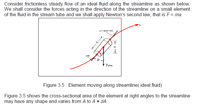

why the author said the equation 3-4 as energy per unit weight ?
as gamma = rho g , gamma has the unit of kg(m^-3)(ms^-2) = kg(m^-2)(s^-2) , gamma is clearly not weight ...
  • Diagram of a small fluid element in a stream tube moving along a curved streamline s, with pressure p and p + dp acting on its ends, weight γ dA ds acting vertically downward, angle θ to horizontal, and height change dz.

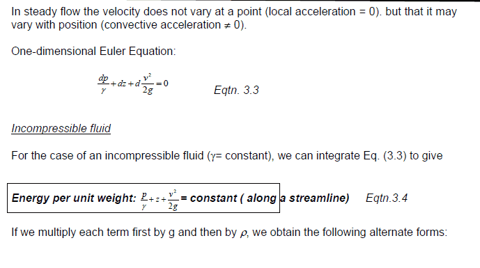

You'll have to supply some additional information about this equation 3-4, which is not included in your attachment.
The quantity γ = ρ ⋅ g is known as the weight density of the fluid, however.

  • Text page of fluid mechanics notes: One-dimensional Euler equation dp/γ + dz + d(v²/2g) = 0 (Eqn. 3.3), incompressible fluid energy per unit weight p/γ + z + v²/2g = constant along a streamline (Eqn. 3.4).
P / γ = height . right ? why is energy per unit weight ?
Work out the units on both sides of the equation.
