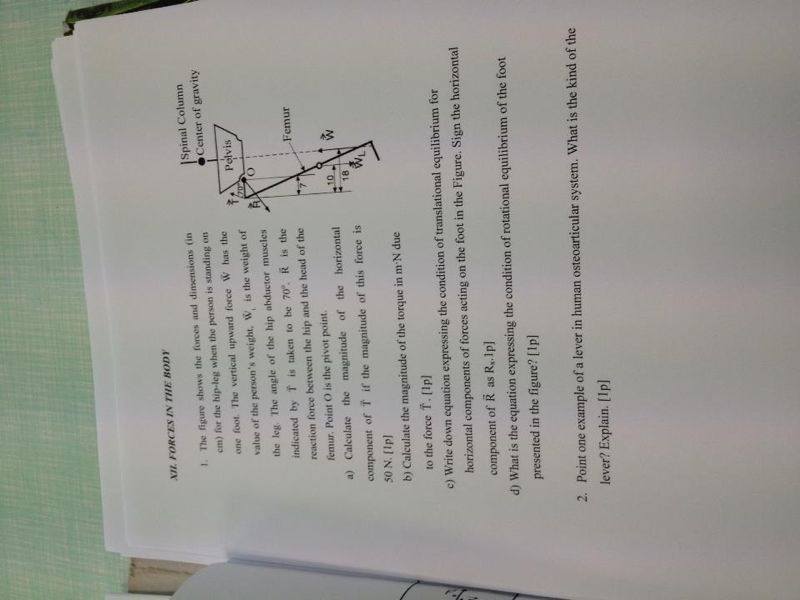

hey everybody :) i am new here and i need ur help. I have to solve this problem for home work tomorrow.Topic is forces in the body.
I attached it. I actually need help for the whole first question.
thx u in advance.
Please try to explain it not too difficulty. thanks u :)

Hi! As per the forum guidelines, you need to show us your attempt at the solution before we can help you. What have you tried so far? Where are you getting stuck?
To get the best from this forum, you should show us your best attempt.
For that problem (1a) you put axis on the diagram and use your knowledge of trigonometry.
i already tried to calculate it. for 1a) i got 17,10N as result. but i am not sure if its right. I calculated : 50xcos70.

If ##\theta## is the angle some force ##\vec{F}## to the horizontal, then the horizontal component of that force is, indeed, ##F\cos(\theta)##
You kept going:
for 1b i got : 50xsin70=46,98 T
You appear to have computed the vertical component of T.
Is that correct?
1b asks for torque
... what is torque?
... what are the units for torque?

i am not here for the pupose that people are doing my homework. i don't understand what u meant by " what are you thinking about this problem".
50xcos70=17,10N
50 stands for the force (which is given) and 70( is given too) for the angle.
relating to 1b)
torque is the tendency of a force to rotate the body to which it is applied. torque is always specified with the regard to the axis rotation.relationship betwenn torque and force is : Torque=F(force)x R (radius or distance ) unit of torque is Newtonmeters.

It is meaningful (but not always useful) to take the torque about any point. Standing on one end of a non-uniform horizontal beam, each point of the beam is a potential break point, so your torque about each point is worthy of consideration.
The question is a little deficient here. It ought to specify the point to take the torque about, but presumably it means O.
Quite so (but to clarify, F and R must be as measured at right angles to each other). You gave as answer 50xsin70 T. Not sure what the T represents in that, so I guess you meant N. But as Simon said, that's the vertical component of T, so it's a force, not a torque. What is the radius here?
