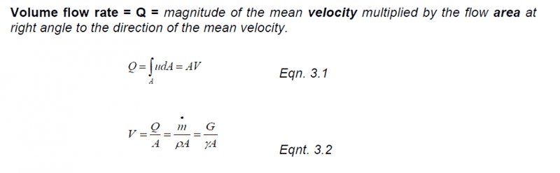

hotjohn Messages 71 Reaction score 1 Thread starter Jan 16, 2016 #1 Homework Statement what is G and γ mean here ? Homework EquationsThe Attempt at a Solution Attachments 7736.PNG 26.6 KB · Views: 480
Chestermiller Staff Emeritus Science Advisor Homework Helper Insights Author 2025 Award Messages 23,756 Reaction score 5,960 Jan 16, 2016 #2 Maybe G is the molar flow rate and gamma is the molar density
SteamKing Staff Emeritus Science Advisor Homework Helper Messages 12,828 Reaction score 1,673 Jan 16, 2016 #3 hotjohn said: Homework Statement what is G and γ mean here ? Homework EquationsThe Attempt at a Solution Here, γ = ρ⋅g, or the specific weight of the fluid, in lbf/ft3 or N/m3, for example. G would be the weight flow rate, in lbf/s or N/s, for example.
