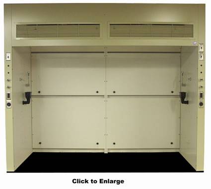

ChemAir said:
-What was the original design basis for the hood? Is the design adequate for use before adding a hydrogen leak to its capabilities? Is the hood design suitable for the presence of significant amounts of hydrogen (no ignition sources)? Is the hood configuration such that it is unlikely to trap hydrogen in places?
Yeah, intrinsically safe walk-in fume hoods do look to be available, but you probably need to be sure it is designed for that (switches, lights, blower, etc.). One example:
http://www.fume-hoods.net/walk-in-fume-hood.html?gclid=EAIaIQobChMIwquoy9qt2wIVl9lkCh2Yvg4BEAAYAyAAEgLIEvD_BwE

Zion309 said:
By the way, the walk-in fume hood is designed as per NFPA standard. Inspection frequency is done as per OSHA with current face velocity at 200 fpm.
There are many NFPA standards. Is your hood approved as intrinsically safe and explosion proof?
Hood Specification: NFPA 45 / ASHRAE 110 / ASTM E84 to comply with NEC / NFPA 70, Class I locations where flammable gasses or vapors may be present in the air in quantities sufficient to produce explosive or ignitable mixtures.
