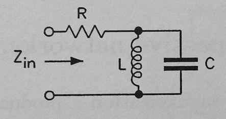

I have some trouble understanding the worked examples below:
Considering the input impedance of the network below:
##z_{in} = R+ \frac{sL/sC}{sL+(1/sC)}##
##z_{in} = R \left[ \frac{s^2+s/(RC)+1/(LC)}{s^2+1/(LC)} \right]##
Where ##s=j\omega##.
How did they get from the first expression to the second expression?
Clearly looking into the network R is in series with the parallel combination of L and C, so we have ##R + L \parallel C## which is the first expression:
We can further write this as:
##z_{in} = R+ \frac{sRL + (R/sC)+(sL/sC)}{sL+(1/sC)}##
I'm really confused. Where does the second expression given above come from? :confused:
Any help is greatly appreciated.
P.S. This is part of a problem about finding poles and zeros of the network. The quadratics in the numerator and denominator of the 2nd expression can be factorized to give the poles and zeros.

Just algebra!
1. cross-multiply
2. factor out R, this means putting a 1/R coefficient in one term.
3. divide numerator & denominator by L.
The above expression is incorrect; the initial R+ shouldn't be there. The expression should be:
##z_{in} = \frac{sRL + (R/sC)+(sL/sC)}{sL+(1/sC)}##
Thank you very much, I got the right answer now! :)
