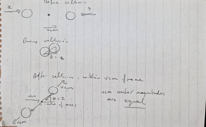

After researching into vcm, I have deduced something really interesting which will help me immensely on my journey, and all thanks to all of you for guiding me on my way.
Right now I am exploring the effects of 2 colliding balls at different speeds only on x axis (albeit at different angles at point of collision). At the moment, to help me understand this better, I am sticking with equal masses.
I have just realised that the velocities of the balls after collision deviating from the vcm are equal to the vcm (in opposite directions, obviously).
Also, from the vcm frame, the angles at which the balls deviate are equal to the angle at which the collision occurred.
Using the vcm frame helps simplify everything wonderfully.
I'm still pondering on all of these relationships and trying to connect everything in my mind.
Really interesting stuff.
You mean the center-of-mass-rest-frame? Yes, that can be another convenient frame.
Note that for the center-of-mass-rest-frame you are still free to orient you axes as you want. A convenient choice is to orient them along the contact normal/tangent, as described above. This eliminates the angles completely.
I thought that the rest frame was the centre of mass frame... (according to what I've understood so far).
Yes, I've learnt that using the vcm simplifies everything brilliantly.
That's right.... I would code JavaScript to calculate the vector components between the centres of the balls and use the inverse tangent method to calculate the angle.
Then this angle would be the one which the two balls deviate from relative to the point of centre of mass.
I am really enjoying this interesting exploration of physics.
This recent study has been a huge revelation, cos I've always been interested in physics but never really researched the mathematics of it, until I decided to code a collision model in JavaScript.
Then it's been a rollercoaster ride of problems and questions and discoveries again and again.
Next step is for me to explore the relationship between the vcm and initial velocities to work out the final angles and velocities.
Thank you for your help so far.
What do you need the angle for? You can transform your velocities into the contact-normal/tangent frame using a simple 2x2 matrix, with the base vectors as rows.
