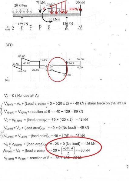

Why does shear force in uniformly varying load region apply at F instead of E?
23 replies · 4K views
chetzread
798
I'm having problem of the shear force at the uniformly varying load at region EF...
Why the shear force isn't -26 +(-30*4/2) at E? but -26 +(-30*4/2) at F?
as we can see the force at region F is 0. the force due to uniformly varying load is (30*4/2) at E...
No. The negative of the area under the load diagram between 2 points is equal to the change in shear between those points. As a check, try drawing a free body diagram of the right section of the beam between a cut just to the left of F and the right end of the beam. What do you get for the shear at that cut section just to the left of F?

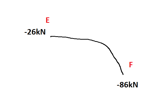

at E, it should be -26 + (-30*4/2) = -86kN, am i right?
As we can see, the weight per unit length start from 0 from right, then to 30kN to the left...So, force above E due to uniformly varying load is (-30*4/2) am I right?

No, please draw free body diagrams. At a section of the right part of the beam cut from E to the right end, look at all the forces acting. The unknown shear V at E, the distributed load down of 30(4)/2 , the reaction load up at F of 136, and the concentrated load of 50 down at G. They must all sum to 0, so V = ??

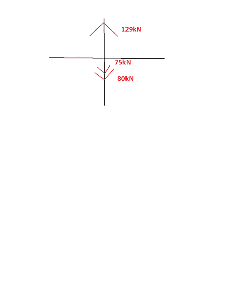

Or maybe you can look at the left section of the beam from left end to cut at E: unknown V at E, 20(4) down from distributed load, 75 down from load at D, 129 up from reaction at B, so V at E = ??

well, here's the free body diagram to the left of section E,ya, i get -26kN
but, why the -30(4/2) act at F? Shouldnt it act at the right of region E?

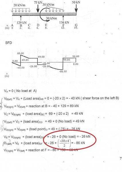

Now, I am having problem with the distributed load...For the shear force diagram to look like this, the uniformly changing load should start from 0 on the left, and slowly become 30kN/m on the right of EF, am i right? (refer to the diagram )

No, you are not right. Firstly, if the uniformly changing load were as you show, the support reactions would change and you would have different values in the shear force diagram and the shear curve between E and F would be convex shape facing downward instead of concave shape facing upward. You seem to be assuming that distributed loads can be treated as concentrated point loads, which is incorrect when determining shear forces along the beam. You must instead follow proper procedures when determining shears, as discussed earlier.

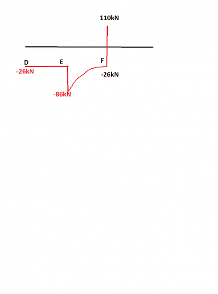

How if the uniformly varying load is in opposite direction ( i have redrawn it in another direction), is the shear force graph at region EF still the same)?

i am not sure convex downwrads, does it mean this?

yes, the curve shape is correct, but the values won't be the same because you have changed the load diagram and thus support reactions will change so all numerical values change. It will still be true that the shear at F will be the shear at E (whatever it works out to be) minus 60, because as you may recall, he change in shear between E and F is the negative of the area of the triangular distributed loading (- 30 times 4 divided by 2 or neg 60 change).
what do you mean?do you mena the shear force at E will become shear force at F?
no. I'm just saying that if you change the triangular distributed load from 0 increasing to 30 kN/m instead of the given example 30 kN/m decreasing to 0, then you change the cg of that load (1/3 of the way from the fat end of the triangle) and thus support reactions change and thus shear forces change. You do know how to calculate the force reactions, right?
