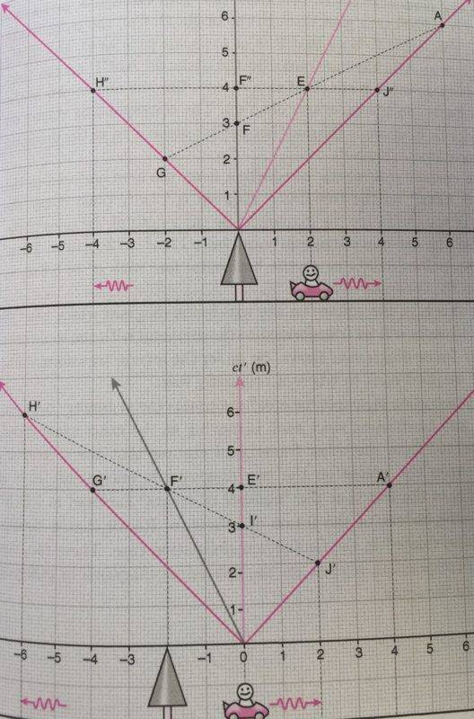

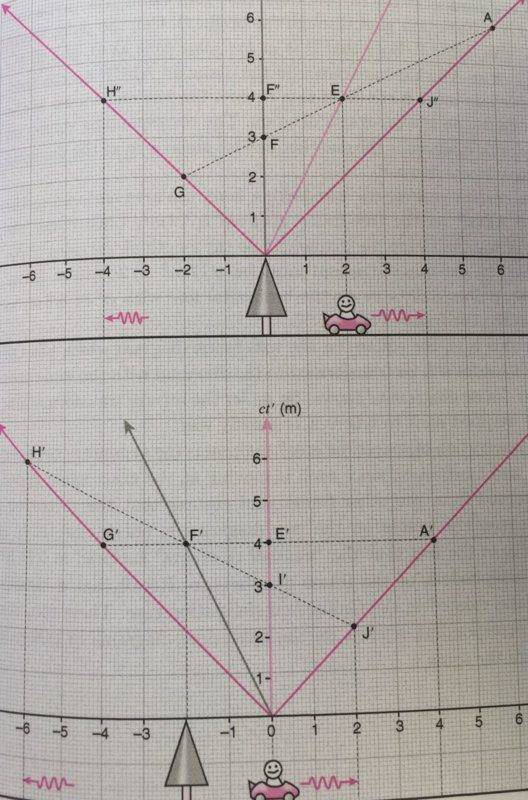

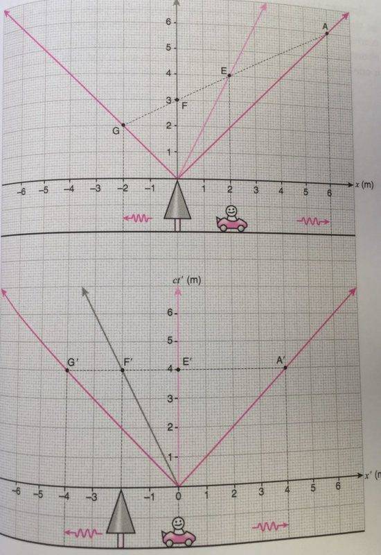

There are six related diagrams I am working with now, each of which deal with two frames of reference: one frame of reference is the "tree frame" where someone is standing next to a tree, and the other frame is the "car frame" where the car is driving away from the tree at .5c. On each of these diagrams, the pink colored line is the world line of the car, the grey line is the world line of the tree, and the two crimson lines are two beams of light:
The top diagram above shows points A E F G in the tree frame which are all simultaneous in the car frame, but which all occur at different times in the tree frame. I understand that from the cars point of view, this line of simultaneity ("LOS") must be slanted so that the LOS is equidistant from both beams of light.
Here's the problem: The author says "I argued earlier that line AEFG in the tree frame diagram must fall on a horizontal line on the car frame diagram, but I haven't said yet which horizontal line it is".
So I assume the author wants us to figure out where on the time axis the horizontal line needs to be drawn in the car frame? He goes on to explain the solution by saying "one is tempted to think that the line corresponds to the points ## A \prime E \prime F \prime G \prime ## on the car frame diagram (second diagram from above) since the spatial separations of the tree, the car, and the two photons in ## x \prime ## are the same as those in x." My only reason for thinking that the second diagram above couldn't be true is that point E, which is the location and time of the car in the tree frame, is at t = 4 in the tree frame, and ## E \prime ## in the diagram below is at ## t \prime = 4 ##. We know that t can't =## t \prime ## for even E because event E happened at a distance from the tree frame, and the car is in motion relative to the tree? I assume, though, that the author is trying to explain it another more visual way. The author continues with another pair of diagrams, the top one which is again in the tree frame and the bottom in the car frame:
He says this cannot be correct because it implies that ## H \prime \prime F \prime \prime E J \prime \prime ## on the tree frame diagram correspond with ## H \prime F \prime I \prime J \prime ## on the car frame diagram. This makes my head spin a bit and I'm not sure I understand his reasoning, and the only reason why I can think that it's wrong is because the event F can't be at the same time, t = 4, in both frames.
Now the author introduces a rule to use to determine where to draw the line in the car frame given where it is in the tree frame, and shows a third pair of diagrams. He calls the rule the "conservation of spacetime volume" rule:
Referring to these diagrams he says: "On the tree frame diagram (first diagram of the above pair), draw a line parallel to the car worldline that goes through A, and a line parallel to AEFG that goes through the origin O. Call the point when the two lines cross P. Note that P is at the same time as O, and at the same place as A, in the car frame. So the diamond AEOP on the tree frame diagram must correspond with a square, like the one in the bottom figure, shown on the tree frame diagram."
How can we conclude that this diamond in the tree frame must correspond with a square in the car frame? To do that, wouldn't we need to know that this distance between O and P is the same as the distance between O and E? How do we know that these distances are the same?
He then continues: "In the current case we are considering here, the area enclosed in the diamond AEOP on the tree frame diagram is ## 12m^2 ##. Just count the number of squares in the diamond."
I have re-read this multiple times and don't how we get ## 12m^2 ## as the area of the diamond in the tree frame diagram. I can't just count the number of squares in the diamond because many of the squares in the diamond are cut up into odd fractions. Am I missing something?
"So the length of the sides of the square on the car-frame diagram must be ## \sqrt 12m^2 = 2 \sqrt 3m = 3.5m. ## Therefore, points AEFG lie on the horizontal line with ## ct \prime = 3.5m, as shown on the car frame diagram."
Just looking at the diamond shape in the tree frame, each side appears to be at least 4m in length, which makes it even more unclear to me about how the author gets 3.5m as the length of the sides of the square in the car frame.
"Under the conservation of spacetime volume rule, the square on the tree frame diagram which has OF as a one of its sides will be transformed to the diamond with the same area on the car-frame diagram as shown. So under the inverse transformation F will be mapped back to where it originally was.
This conservation of spacetime area maintains the symmetry between the tree and car frames, since each is moving at the exact same speed when observed from the other frame, and ensures that the correspondence between the points on the two diagrams is one-to-one. It is a consequence of the fact that the "number of events" enclosed in AEOP must be independent of the frame of reference."
So, is the spacetime conservation rule an alternative method, in situations like this, to using the lorentz transformations? When I used the lorentz transformation in the above example to convert the time of event E in the tree frame to the time of event E in the car frame, I got the same answer of 3.5.

I am getting the impression that this is not a great book. It seems to be taking the view that showing you a number of wrong ways to do something will help you understand the right way. I'm not convinced.
The easy way to see that the first two diagrams must be wrong is the absence of length contraction. If the tree says the car is 2m away, the car cannot agree that the tree is 2m away.

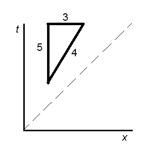

The problem with the area of the square is that ##2\sqrt 3## is about 3.46, not 3.5. The diagram doesn't have sufficient resolution to show that it's a 3.46×3.46 square, not a 3.5×3.5 square. So you cannot count the area accurately, as the text asks you to do. The author should have chosen a speed of 0.6c or 0.8c - the numbers come out rational.
Regarding lengths - you cannot (in general) just measure lengths on the diagram. It's a Euclidean representation of a plane that does not obey Euclidean geometry, and measuring lengths on it has similar pitfalls to measuring distance on a Mercator projection map. It works in special cases (parallel to the x or t axis in this case) but not in others. That's why the lengths of the sides of the representation of the parallelogram that is drawn are not the same as those of the square. If you measure ##\Delta x## and ##\Delta t## along the line (you are measuring parallel to the axes, so that works) and compute the interval, ##\Delta s=\sqrt{|\Delta x^2-\Delta t^2|}##, that will be 3.46m, give or take rounding error from the author's poor choice of frame speed.
Honestly, I wouldn't faff around like this. You know the Lorentz transforms. Suppose you want to draw the line of simultaneity for the primed frame at ##t'=4## on the unprimed diagram. ##t'=\gamma(t-vx/c^2)## tells you that you want to draw ##t=4/\gamma+(v/c^2)x##. Draw that line. Job done.

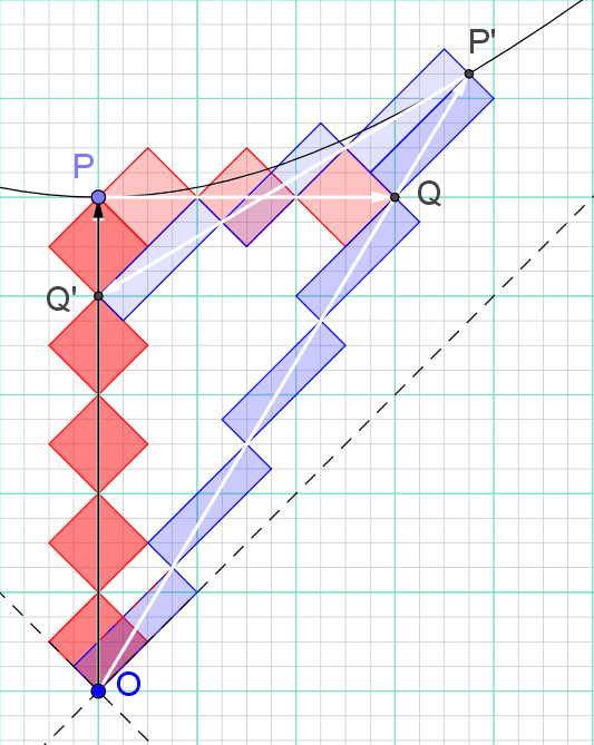

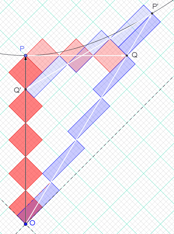

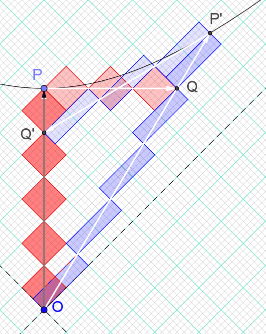

The construction with the areas of the "diamonds", is pretty clear algebraically. It's also the foundation of the Bondi approach and the visualization with "rotated graph paper" mentioned above. In the algebraic approach it's very simple: What's invariant is the Minkowski "length", i.e.,
$$\Delta t^2-\Delta x^2=\Delta t^{\prime 2}-\Delta x^{\prime 2}$$
for an arbitrary space-time interval. The introduction of the "rotated graph paper" is algebraically nothing else than expressing everything in light-cone coordinates ##x_{\pm}=t \pm x##. Then the above invariance property simply becomes
$$\Delta x_+ \Delta x_-=\Delta x_{+}' \Delta x_-',$$
i.e., the areas of the diamonds in the two frames are the same.
So you can construct the units in the moving frame, given the units in the primed frame by making these diamonds of equal area as well as by drawing the unit hyperbolae ##t^2-x^2=\pm 1## and then getting the units on the ##t'## and ##x'## axis by the intersections of these lines with these hyperbolae.
Another way to see it with the unit hyperbola is the following, using rapidities: Written in space-time coordinates you have for e.g., the time-like unit hyperbola
$$\begin{pmatrix} t \\ x \end{pmatrix}=\begin{pmatrix} \cosh y \\ \sinh y \end{pmatrix}$$
and in light-cone coordinates
$$\begin{pmatrix} x_+ \\ x_- \end{pmatrix}=\begin{pmatrix} \exp y \\ \exp(-y)\end{pmatrix},$$
i.e., ##x_+=1/x_-##, i.e., for any point on the hyperbola ##x_+ x_-=1##. As I said, the algebra is much simpler than space-time diagrams ;-))).

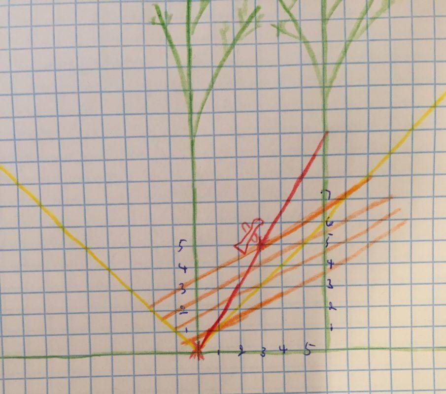

I am assuming that based on the speed of the car, there is a formula which tells you what angle to draw that line at?
Yes - the Lorentz transform, as I said in #11. The point is that the line of simultaneity is defined as the line of equal ##t'##. So if you set ##t'=T'##, where ##T'## is some constant (I used 4 in #11), then the line of simultaneity on your unprimed frame's diagram is the ##(x,t)## values that Lorentz transform to ##T'##. Thus ##T'=\gamma(t-vx/c^2)##, which you can rearrange into ##t=(v/c^2)x+T'/\gamma##.

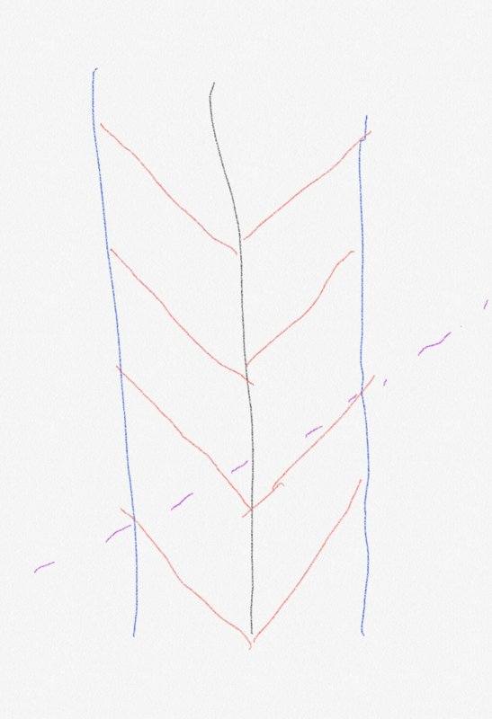

NoahsArk said:
From this why not conclude that the person on Earth will measure time moving faster on the rocket? Somewhere I've gone very wrong I just don't know where?

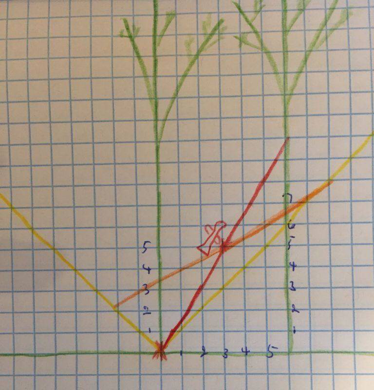

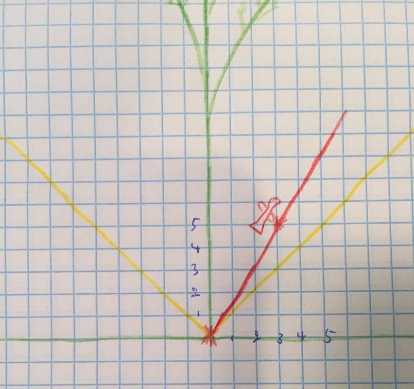

As @Pencilvester comments, you've forgotten the relativity of simultaneity. I sketched a Minkowski diagram below - please excuse the lack of straight lines.
This is drawn in the frame of the rocket. The black line up the middle is the laser and the blue lines are the front and rear of the rocket. The red lines are the laser pulses, arriving at the front and rear at the same times as each other in this frame, and at the same time in this frame as the next pulse is emitted. But I've also added a purple dashed line, which is the line of simultaneity of the Earth frame. Note that the three events are not simultaneous in the Earth frame - which is what is wrong with your analysis. The reason for using a round-trip style clock in the standard approach is that the next emission event happens in the same place as the pulse return, so there is no ambiguity about simultaneity.
You can go a huge way towards avoiding this type of error by reviewing anything you write and searching for any word like "simultaneously" or "at the same time" and adding which frame regards the events as simultaneous.

Ibix thank you for the diagram. Doesn't this show, though, that the typical way of explaining time dilation, i.e., with a light clock, is not the real explanation for time dilation? The whole reason why the light clock is supposed to show time dilation is that the beam of light in the Earth frame is traveling a longer path than the beam in the rocket, and c is the same speed in both frames. In the laser gun example, though, the beam is traveling a shorter distance than it is in the rocket frame. So, is it true that we can't say that time dilation occurs due to the longer distance of the light traveling in the Earth frame? As you pointed out, the longer time has to do with ROS.

Here are two 3-4-5 triangles in Minkowski spacetime.
Can you see them?
This is how I use graph paper to draw spacetime diagrams,
as @pervect mentioned in an early post in this thread.
These diamond edges are traced out by the light rays of a light clock carried by inertial observers.
All of my clock diamonds have the same area... and this follows from the Lorentz transformations,
which preserve the light-cone and (since its determinant equals one) preserves the areas of regions in the plane. So, you can see the tickmarks are marked off according to this "invariant unit area" ... and you can calculate by counting.
And, as @vanhees71 said, back here in #6 and here in #12, I am secretly (or not secretly) using light-cone coordinates, which is actually the simplest coordinate system because it's the eigenbasis of the Lorentz transformation: the eigenvectors are along the light-cone and the eigenvalues are the Doppler factors (the "k" in Bondi's "k- calculus). In this diagram, k=2 defining the stretch along the forward lightcone is the Doppler factor corresponding to v=(3/5)c.The timelike diagonal follows the worldline of the inertial observer.
The other diagonal is spacelike and is Minkowski-perpendicular to that observer.
This is an instant of time for that observer.
"Her spaceline is Minkowski-perpendicular to her worldline ["timeline"]."
For the timelike line OP, this spacelike diagonals of her diamonds are parallel to the tangent to the hyperbola at P.
This is how Minkowski defined "perpendicular" (but he used "normal", according to the translation).
The tangent line [to the hyperbola] is Minkowski-perpendicular to the radius.
The Minkowski-right-angle is at P... so the other side OQ is the hypotenuse.
See OP' and OQ' for the other 3-4-5 triangle.There are many things that can be read off of this diagram, with practice.

Suppose a rocket ship is moving in a straight line, just above a long straight section of roadway at a speed of 0.6c (relative to the road). A tiny explosion on the ship generates a spark that leaves a mark on the roadway, and then 4 seconds later (as measured by a clock on board the ship) another tiny explosion on the ship generates a spark that leaves another mark on the roadway. A person stands still on top of each mark, They measure the distance between the marks to be 3 light-seconds. Each person has a clock with them (they have synchronized their clocks with each other) and determine that the time that elapsed between explosions is 5 seconds.
I drew a picture of that situation here.
I am drawing this from the "tree frame" where a tree is standing at the origin 0,0 along the road as the rocket flies by and emits the first spark at 0,0. The world line of the tree is green, and the world line of the rocket is red. The yellow lines are two beams of light. Just to get some practice with different concepts using this same example, I tried to draw a line of simultaneity for the rocket at the point of the second explosion (the explosions are marked with asterisks). That looks like this:
This shows that from the rocket's perspective, the tree frame's clock read 3.2 seconds during the time when the second explosion occurred. The orange line is the line of simultaneity of the rocket, and it goes through 3.2 on the tree frame on the left tree. I drew another tree in this frame on the right side as well which shows that at the second explosion, a clock on the right tree would read about 6.8 (I should have drawn the second tree at x= 5 in the tree frame to make it easier, but this should do for now). Is this so far correct?
I also wanted to use this example to see how far apart the lines of simultaneity should be in the rocket frame. In other words, how to show time dilation in the diagram:
This diagram shows that each line of simultaneity should be .8 meters apart. Since v = .6, gamma = 1.25. So, when t = 1, ## t \prime ## should be .8, when t = 2, ## t \prime ## should be 1.6, etc. Is this correct as well?
