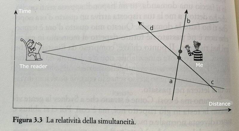

I don't understand a spacetime diagram about relativty and simultaneity that I found in a book and its explaination by the author
I'm reading a book called "Reality is not what it seems: the journey to quantum gravity" by Carlo Rovelli and I'm struggling to understand this diagram that is part of the chapter about special relativity.

First of all I don't understand what it means that "the moment in the middle of my quarter of an hour can be considered simultaneus to your answer". I tried to draw diagrams, I'm really struggling but I can't grab the concept. Talking about the diagram, why can we say that the observer perceives the two dots as simultaneous? They don't exit his past and enter his future at the same time, do they? In these diagrams souldn't we find simultaneous events on the same horizontal line?
I'm completely stuck, I would be very grateful if you could help me.
The observer ('the reader') has no way of knowing whether any distant events happen on the horizontal line or not. He has to exchange signals and try to use some convention for deducing when that thing happened. On Earth, pretty much everything is relatively stationary (any arrow drawn on the diagram would be vertical), which let's us use the convention described above - every event half-way between reception and emission does happen on the same horizontal line as the reader's position.
The argument here is that if we tried using the same convention when the communicating objects are not nailed to the ground, we'd arrive at different answers depending on how the objects move. Which makes the aforementioned convention pretty useless.
Just to clarify what's on the diagram:
The sender ('Me') is traveling along one of the two arrows relative to 'the reader' (from a to b in one case, and from c to d in the other case), while the reader is considered stationary. The movement is shown in space-time, so in spatial-only terms the sender is moving away from the reader in one case (a-b), with some speed, and towards the reader (c-d) with a different speed.
The long lines show the path of the signal from emission (points a and c) to the reader, who responds and sends the signal back to sender to be received where and when the line intersects the arrow again.
In the first case the sender sends the signal at point (in space-time it's called an 'event') a. In the second case, it's at event c.
The signal travels to the reader along the line shown. It is reflected back to the sender, and is received by him at event b or d, respectively.
The key is, the differently angled arrows intersect with the path of the signal in such a way, that the half-way point between emission and reception (the middle of the a-b and the c-d lines) is in different places. These are those dots marked on the arrows - in particular, as you notice, they're not on the same horizontal line (not the same time coordinate).
So if you were to try and apply the same convention for assuming when the answer was composed as was tried before, by halving the signal travel time, you'll arrive at different answers depending on the relative motions between the sender and the reader.

Thank you for your explanation, it was really clear!

That all seems very confusing to me (and I'm not sure it's caused by poor translation). I don't like complicated wordy descriptions like, as I find them hard to follow.
It may be that Rovelli wants to say more than just that simultaneity is relative, but I've seen much simpler presentations of the basic idea.
Likes fee_de and vanhees71
Also a real Minowski diagram may be much clearer. Looking at Rovelli's picture alone, I don't understand it too.

Honeslty I think you are right. I generally like him as a science writer but in this book he made general relativity easier to understand than special relativity ^^"
Likes vanhees71 and PeroK
I think there are two aspects to the relativity of simultaneity. The first is the (relatively simple) kinematic calculations to show that universal simultaneity and the invariance of light speed are incompatible.
The second, which is perhaps more difficult to grasp, is that there is no global "now". If we are watching a live event on TV which is happening on the other side of the world, then we are able to imagine that happening "now" and our concept of "now" across the planet is well established. So, it's difficult to realize that that idea does not extend to all circumstances. What does "now" in the Andromeda galaxy, which is 2 million light years away, really mean? Even without relativity, you can ask what "now" at such great distances might mean.
And, of course, once you have relative motion the whole idea of a global, shared simultaneity vanishes. Even if you establish a convention for now on Earth and now in Andromeda, that doesn't extend to reference frames where the Earth is moving.
