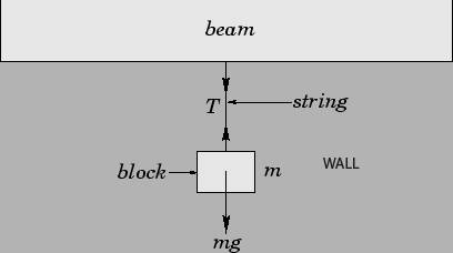

If you have a pin tied to a string carrying a stone in the wall. And you put epoxy to the stone and wall attaching them. How is the stress transferred from the pin to the interface between stone and wall? What method is used to model the transfer function?

J/K. You really need to attach a sketch of this situation, and show your FBD please. Thanks. :smile:
Imagine you put glue between block and wall. As the glue hardens, how do you model the string tension slowly diminishing and the weight or tension transferred to the glue? Or what is the best technical language to describe it?
In the analysis. Let us treat the string as fixed and not flexible. This is because when you glue the block and it got stuck to the wall with the string in tension. It would remain in tension (imagine a rubber band). So treat it as string made of iron (or something which doesn't stretch like a chain). Now I want to know what happens when the glue/epoxy hardens slowly. Does the string slowly lose weight it supporting in proportional to how the glue hardens? How is the stress transfer function of such dynamics?

Stated like that, the answer is No. Why would it? The position of the mass does not change during the hardening of the glue.

But when the glue hardens. The block is stuck to the wall and no longer has weight to the string. So why would the string still feel weight, it's like the block is weightless already because it is fully epoxied to the wall.

The weight stretched the string and the string is still stretched, so it still has tension in it.
If you think of the epoxy as supporting the weight of the mass then you have to ask why the string is stretched. The weight isn't stretching it any more, so what is? The answer is that the epoxy is not permitting it to shorten. The force required to keep it stretched is equal to the weight of the mass - so in total the force on the epoxy is zero.
It seems easier to say that gluing the epoxy to the wall changes nothing. But I don't think it's wrong to say that the epoxy is both supporting the weight and stretching the string, and that the two forces are equal and opposite.

How would it change the analysis if the string is a thick steel cable?

I would replace each instance of the word "string" in my post with the words "thick steel cable".

Are you saying there would be same stress in the steel cable only the capacity is much more?

Stress is a force per unit area. The force (the weight of the mass) would be the same for the string or the cable (neglecting the weight of the string/cable), but if your cable is "thick" then the area would be much larger than that of the string and the stress would be much lower. If the cable had the same cross-sectional area as the string then the stress would be the same, yes.
The strain (the extension divided by the natural length) of the cable would probably be much lower than that of the string because the cable has more tensile strength. But that strength is not infinite, so the cable would stretch very slightly and my analysis in post #7 remains the same.
