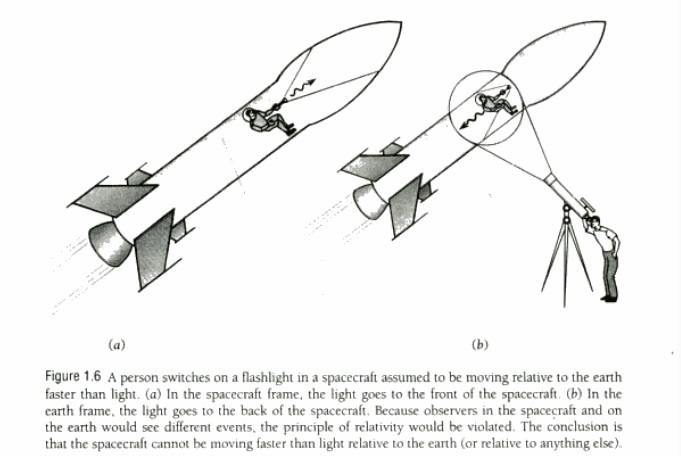

Why would light go to the back of spacecraft in the Earth reference frame as shown in figure b? Didn't get that.

The pic is for the situation that the spacecraft could travel faster than light, while keeping the speed of light the same for all observers.
You may be thinking of the situation where I, riding in the back of a bus at 40 mph, throw a ball forward at, relative to me and the bus, 50 mph. Relative to you, standing at the side or the road, the ball is traveling at 50+ 40= 90 mph (approximately).
But the basic concept to relativity is that the speed of light is the same for all observers. If, instead of throwing a ball, I pointed a flashlight forward, you would see the light still moving at speed c, not at c+ 40. If I were on a spaceship moving with speed v, you would see light moving at c, not c+ v. If v were greater than c you would see the light moving backward relative to the rocket because the rocket is faster. (0f course, relativity says it is impossible for an object to move faster than light so this whole scenrio is fishy!)

HallsofIvy said:
If I were on a spaceship moving with speed v, you would see light moving at c, not c+ v. If v were greater than c you would see the light moving backward relative to the rocket because the rocket is faster. (0f course, relativity says it is impossible for an object to move faster than light so this whole scenario is fishy!)
Not only that, but rocket observer also has to observe the speed of light to be c, meaning that if it started in front of him moving away, it will stay in front of him and move further away. Try reconciling that with your view of the light falling behind the rocket, and you'll conclude that the scenario isn't just "fishy", we're talking serious hakarl here.

It wouldn't. That's the point of the picture. It shows that FTL (faster than light) travel is inconsistent with a constant light speed which is one of the pillars of the relativity theory.
In my opinion the argument against FTL shown in the picture is flawed, because it omits length contraction. If you want to play the "what if the rocket was going FTL"-game, then you also have to extrapolate length contraction beyond the c limit. And depending on how you do this, you can create consistency with the two postulates of SR. For example, if the extrapolated length contraction would mirror the rocket along its movement direction (negative contraction factor) the light could move away from the astronaut at the same speed in both frames.
DISCLAIMER FOR MODS: I'm not trying to speculate what happens at v>c. I'm merely pointing out, that the presented argument assumes v>c and pretends to know how the rocket would like at v>c. The way the rocket is drawn in the Earth's frame contains unjustified hidden assumptions.
got that.
@AT: the argument is demonstrating the need for some sort of transformation to make the results consistent rather than demonstrates that the postulate of invariance for some speed means that nothing faster will be observed. Yah. So there are a bunch of unspoken assumptions based on the assumed education level of the audience perhaps?
