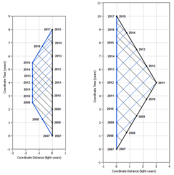

Hey guys, I just want to ask a quick question that confuses me a bit regarding the twin paradox. During acceleration, the moving twin very quickly 'runs over' across a large segment of the worldtube of the stationary twin. But, what is the perspective of the stationary twin during the acceleration of the moving twin (or during its change of frames). Does the stationary twin also run over across the part of the worldtube of the moving twin that is accelerating?

Regarding the definition of "now": in relativity, "now" is not a fundamental concept; it's a convention. If you are moving inertially forever, the obvious convention to choose is the standard one, the one that matches the "now" surfaces of the inertial frame in which you are always at rest. But if you ever change your state of motion (meaning, if you ever feel acceleration), there is no unique way for you to define "now", and every possible way to do it has some counterintuitive properties. These counterintuitive properties can cause a lot of confusion if you don't realize that "now" is just a convention; but that in itself is counterintuitive, so it's not surprising that it takes a while to really understand how it works. It took me a while too when I was first learning about it.
A slightly tricky thing to understand in relativity is that "now" for any remote location is just a convention. So the fact that the traveling twin "now" (by the stay-at-home twin's definition) thinks that now on Earth (by the traveling twin's definition) is yesterday (by the stay-at-home twin's definition) isn't really significant of anything. They could both define "now" in a different way and come to a different conclusion - which is what is happening when the traveling twin accelerates.
So - there is no "jump in time". There's just the traveling twin resetting her clocks at turn around, in order to match her new choice of "now".

The basic thing I don't understand is the relative simultaneity in this case. In the last part of the 'out-trip' the stationary twin has the past of the moving twin as his present, from his reference frame, relative to another observer which is at rest with the moving twin. But after the u-turn, the present moment for the stationary twin (regarding the rocket and the twin that is moving) becomes the future of the moving twin, relative to the observer that is at rest with the moving twin. I don't really understand how this can happen, how does the time dilate from the perspective of the Earth twin during each acceleration of the trip, especially during the u-turn?
For example, if the moving twin is heading away from the twin (like in the outbound trip) then of course the moving twin can conlude that his present is filled with past moments of the moving twin. So let's imagine that the moving twin decides to slow down, deaccelarate, to the state of rest relative to the starionary twin after the outbound trip. After he comes to rest, the stationary twin must conclude that his present is the same as the present for another stationary observer that underwent deacceleraiton with the moving twin. From this it follows that at one point in time the stationary twin's present was the past of the moving twin, and after deacceleration it seems that the time went straight-forward a lot.

Simultaneity is an issue concerning the Coordinate Time of an Inertial Reference Frame (IRF) and has nothing to do with the Proper Time on any clock at any particular event. If you analyze the twin situation from the IRF in which the stationary twin is at rest during the entire scenario, then you will have one definition of simultaneity. If you then use the Lorentz Transformation (LT) process to get to a different IRF moving at a constant rate with respect to the original IRF, you will get a whole new set of Coordinate Times for the same events (like the turn-around) and therefore a whole new set of simultaneity issues.
There is no IRF in which the moving twin remains at rest during the entire scenario so the best you can do is consider the IRF in which he is at rest during the outbound trip or the IRF in which he is at rest during the inbound trip. Both will yield a different set of speeds, time dilations, simultaneities, and distances for and between events but they all will yield exactly the same results for the Proper Times at those events and what each twin sees of the other ones clock compared to their own during the entire scenario.
The other option you have is to apply a non-inertial reference frame to the moving twin but there is no standard way to do this and no transformation process that takes care of everything automatically for you like the LT. You have to say how you want to build such a frame. In that case, all the issues of speeds, time dilations, simultaneities, and distances become quite fickle.

That's a great answer, and I appreciate it, but can you describe me the sequence of events on the worldtube of the moving twin from the stationary twin's perspective. I still haven't found out how does he perceive time flowing from his perspective during the u-turn, and how can he first 'perceive' the past of the moving twin, and after the turnaround his future, relative to another observer which is at rest with the moving twin.
I have made a lot of spacetime diagrams to depict twin scenarios. Do a search on my name with the word "diagram" and you will find lots of threads that discuss these issues. Let me know which ones help the most.

I did a search and found a thread that I think might address your issues:
https://www.physicsforums.com/showthread.php?t=671398&page=2
Look at my posts #35 and #36.

Instead of thinking in terms of a twin's perspective, you should think in terms of a reference frame. If you mean the IRF in which the stationary twin is at rest during the entire scenario, then you shouldn't be thinking in terms of any other frame, including any frames in which the other twin is at rest during part of the scenario.
The other twin doesn't change frames. You could say that the other twin is at rest at different times in two different frames but he is always in all frames as is the other twin. Both twins are in all frames all the way through the scenario, they just are at different speeds in the different frames.
I thought it was obvious in the three frames in post #35 of the above link that both twins were in all three frames. Nobody has to jump frames.

I still don't understand the hypotethical scenario in which he concludes that he 'perceives' (has in its present plane of simultaneity) the past of the moving twin relative to the perspective of the observer that is at rest with the moving twin. After deccleration to the state of rest relative to Earth, an observer which is at rest with the moving twin and the stationary twin must have the same temporal slice as their present. How is that possible and what happens during acceleration to balance the views from these frames?
Can you state one of the diagrams and what issues of simultaneity you are asking about. Remember, all events on the same horizontal line in any diagram are simultaneous in that diagram. The same events in another diagram are not simultaneous.
Simultaneity is not "preceived' by any observer. It can only be the result of making radar measurements and observing Proper Times and applying Einstein's second postulate (that the signals travel at c) and construction of a Coordinate System. Do it any way you want. You can either follow the well established conventions of Special Relativity or make up your own. It's not an issue of nature. It's a man-made construct. Let Einstein do it for you for IRF's or you can follow the construct of the radar scheme that I show in the last diagram of post #36 or tell us what you have in mind. Those are your options. There's no right way or best way or preferred way. It's all because time (and space) are relative.

"Simultaneity" is another concept like "time dilation" which is not fundamental, and IMO is better discarded until you have a good understanding of the scenario using the spacetime viewpoint. A particular problem with simultaneity is that it tempts you to think of "present", "past", and "future" as being "real", instead of just conventions. In relativity, these are just conventions; they depend on the coordinates you choose. The only invariants are causal relationships: timelike, spacelike, or null (lightlike) separation between events.

This illustrates the problem with focusing on "simultaneity" instead of on spacetime. What the stationary twin "perceives" here is not "real"; it's just a convention. When the moving twin turns around, his simultaneity lines change orientation relative to the simultaneity lines of the stationary twin; but those lines are just imaginary lines drawn in order to assign coordinates to events. The changes in those lines are not "real" any more than the lines themselves are.

Ok, I get it from the perspective of the moving twin, that his lines of simultaneity change orientation. But what happens from the stationary twin's perspective? I still don't understand it. How come his lines of simultaneity do not change orientation, since we can consider him to move away during the first leg of the trip, and therefore having events that are past (or that preceded others) in his present, and after that he has future events of the moving twin that can be considered to be his present. I still don't understand it. This disbalance confuses me.

The simultaneity lines for a given observer will depend only on features of that observer's world line, which is absolute-one observer is accelerating and the other one isn't there is no symmetry in this regard. The simultaneity lines aren't determined by the physical trajectories of observers as represented in different coordinate systems, which is relative and can be symmetrical in the manner of which you speak.

JesseM said:
Do you understand that acceleration is absolute in relativity? There is no doubt about which twin accelerated to change direction and which didn't--the one that did can measure G-forces during the acceleration. Also, the laws of physics don't obey the same equations in non-inertial coordinate systems as they do in inertial frames, so that's a more general way to distinguish them.
I do, but what's bothering me is in fact the difference between simultaneity in two perspectives. The first one is the observer which is at rest with the moving twin and the events that the considers to be happening now over a period of time. The second is the home twin. From the perspective of the home twin, the events on the worldtube of the moving twin that he considers present are past, or happened before, the events that the observers which is at rest with the moving twin consider to be present. Then after the turnaround, on the inbound trip, the events that the stationary twin considers to be present are really the future, or happened after the events that the co-moving observer considers to be the present. This is what confuses me. The description of two perspectives and why the twin, for instance doesn't consider the past of the moving twin to be his present all the time, but in fact, it's first past, then after the turnaround, the future.
Hi analyst5, I have read all of your posts in this thread and I have no idea what you are asking.
For instance, this sentence makes no sense that I can tell. I cannot decipher what you mean.
Let's take the following situation for definiteness. We will use unprimed coordinates for the stay at home twin's frame, O, single primed coordinates for the outgoing inertial frame, O', and double primed coordinates for the ingoing inertial frame, O'', and we will fix the origin of all three frames at the event of the twin's separation. We will use ##\tau_H## to refer to proper time along the stay at home twin's worldline and ##\tau_T## to refer to proper time along the traveller's worldline. In O the traveller travels at .6 c in the x direction for 5 y and then instantaneously turns around traveling at .6 c in the -x direction for 5 y, meaning that he travels to a point x = 3 ly.
Can you explain with numbers using this scenario precisely what it is that bothers you?
I still don't understand what this means. Did you see I had posted two posts in a row, and that the one before the one you just responded to asked for clarification on this phrasing, in the context of a simple numerical example?
