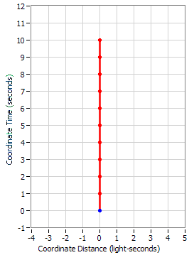

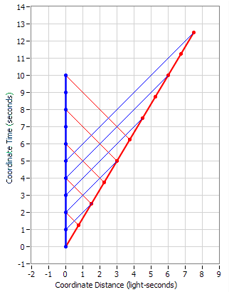

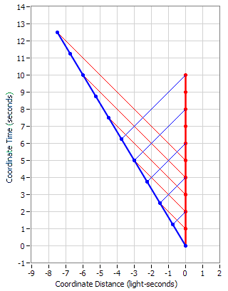

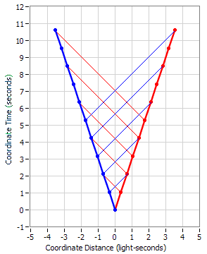

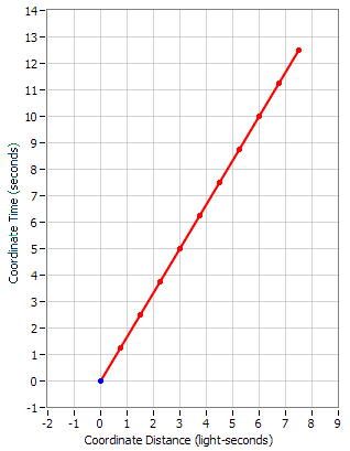

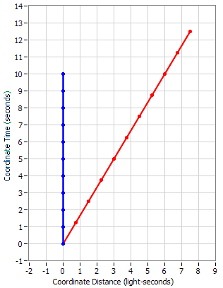

OK, we'll take this problem. We'll start with the twin on the spaceship and I'm going to do what I suggested that you do in post #4. First, I'll show the spaceship twin at rest in his own Inertial Reference Frame (IRF). The dots show 1-second increments of his time:
Next I'm going to use the Lorentz Transformation to see what he would look like when he is traveling at 0.6c to the right (by transforming to -0.6c):
Now you can see his time is dilated according to this new frame. Gamma at 0.6c is 1.25 which means that his 1-second increments of time have been stretched out to 1.25 seconds of Coordinate Time.
Next I'm going to add in the Earth which is stationary in this frame:
As you can see, Earth's time is not dilated because its speed is zero and gamma is 1.
But now I want to add in one more feature and that is how each twin views the other twin. To do this, I add in light rays that go from the dot of each twin to the other twin along 45-degree diagonals:
As you can see, each twin sees the other ones clock ticking at one-half the rate of his own. This is called the Relativistic Doppler Effect (RDE) and shows us what they can really actually see. They cannot see the Time Dilation because it is frame dependent but the RDE is not dependent on the frame.
To illustrate, let's go back to the rest frame of the spaceship twin:
Note that all the light rays are traveling at c and they arrive at the same Doppler-shifted rate as before but the Time Dilation has shifted from the spaceship twin to the blue Earth twin.
And to make the point even clearer, I'm going to transform the original diagram to a speed of 0.33333c:
In this diagram, the Time Dilations of both twins are the same because they are traveling at the same rate (0.333c) in the frame (in opposite directions) and they also continue to see each others time going at one-half the rate of their own. At 0.333c, gamma is 1.06 so that is the Time Dilation factor.
The point of all this is to show how Special Relativity successfully incorporates the observations of each observer into any arbitrary IRF and how it assigns frame-dependent parameters (such as Time Dilation) that are a result of the speed of light being c in any IRF.
So the answer to your question is that just like we assign the speeds arbitrarily according to our IRF, the Time Dilation follows from the formula for gamma based on speed. In other words, it depends on the IRF. But what always happens, independent of the IRF, is that each twin sees the other one aging at half his own rate.
