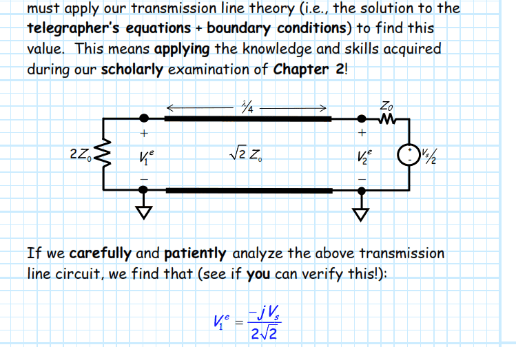

In this problem I tried to find the voltage at 2Z0 (load) that is (landa/4) from generator.My result it is different from teacher's result.what is my mistake?
(I named V1e as A point and V2e as B point so the voltage across the B point is (Vs/4) according to Zin=Z0 that is the same as Z0 of generator's impedance)
Circuit schematic of a quarter-wavelength transmission line with a 2Z0 resistor and a source at the left, labeled V1e at the left terminal and V2e at the right terminal, the line marked lambda/4 with impedance sqrt(2) Z0, and a Z0 resistor and source of Vs/2 at the right; below it the equation V1e = -j Vs / (2 sqrt 2).

Why does it say "√2Z0" in the middle of the line? The chas. impedance of the line is by definition Z0.
So change your source impedance to Z0/√2 and your load impedance to √2Z0 or you're going to get mighty messed up.

In this problem it assumes that Zc=√2 Z0 it means that the characteristic impedance of line is Zc not Z0 and the other values are Z0 and 2Z0 they don't need to be changed
