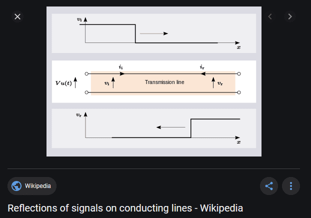

If we send a voltage pulse of amplitude ## V_0 ## through a lossless transmission line, what does the voltage at the output look like when the load impedance is ## \infty ## (i.e. open circuit). We can assume that the time taken by the pulse to traverse the line ## \tau ## is much greater than the duration.
Reflection coefficient
Hi,
I was recently attempting a question about transmission lines and I don't seem to really understand how the voltages travel through the line.
Question:
If we send a voltage pulse of amplitude ## V_0 ## through a lossless transmission line, what does the voltage at the output look like when the load impedance is ## \infty ## (i.e. open circuit). We can assume that the time taken by the pulse to traverse the line ## \tau ## is much greater than the duration. The source impedance is equal to the characteristic impedance of the line ## Z_0 ##.
My approach:
We know the expression for the reflection coefficient ## \rho ## in this case at the end is given by:
$$ \rho_{end} = \frac{Z_L - Z_0}{Z_L + Z_0} = \frac{\infty - Z_0}{\infty + Z_0} = 1 $$
and at the source it is:
$$ \rho_{source} = \frac{Z_L - Z_0}{Z_L + Z_0} = \frac{Z_0 - Z_0}{Z_0 + Z_0} = 0 $$
By using the wave equation, we can derive the following solution for the voltage:
$$ V(z, t) = ( Ae^{j \beta z} + Be^{-j \beta z} ) e^{j \omega t} $$
where ## \beta ## is the propagation coefficient. I thought that this wave solution meant that there are forward and backward traveling waves which would each be of height ## V_0 / 2 ##. Therefore, the backwards traveling wave would be absorbed by the source and the forwards traveling wave would have an amplitude ## V_0 / 2 ## which would reach the end at time ## \tau ##. Then it would be reflected and sent backwards and then absorbed by the source.
However, the answer says that the voltage on the end is of amplitude ## 2 V_0 ##, but I don't really understand how this can be the case?
Would anyone be able to explain to me why this is the case? How does the voltage actually double? I think this means that my understanding of how the forward and backwards wave travel is incorrect.
Any help is greatly appreciated. Thanks.
Master1022 said:
However, the answer says that the voltage on the end is of amplitude , but I don't really understand how this can be the case?
What end? At the far end you will get double as the outgoing pulse and reflected pulse add, but as the pulse travels back to the source after it passes itself, it should just have amplitude ##V_0## AFAIK.

Okay, so if I were to include the 'velocity initial condition' for the pulse I would find that the two waves were actually of amplitude ## V_0 ## and not ## V_0 / 2 ##?
On a transmission line not properly terminated, their will be (total) reflection of a pulse. The remaining incoming pulse will add to the reflecting pulse, and so the result depends upon the details of the pulses and the termination.
You have not specified your problem sufficiently for me to understand what ##V_0## represents (or at least I can't find such specification), so I can't answer.
Maybe this will help.

Hard boundary is shorted line soft boundary is open line. For the open line you can get a pulse that is double the incident pulse.
D'Alembert's solution is general, but its direct utility is limited. As @Joshy noted the pulses need to be separated in order to see the stru cture. For the infinite string, no driving force, initial conditions as given the solution is good. If end point boundary conditions are specified one is restricted to use sinusoidal waves for the f and g functions and their relative phase must be chosen with care. Fourier analysis is where one is led .
Also I think that the Wikipedia version is a little more complete. N.B. their discussion of the inhomogeneous term (which is how you add the source).
