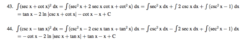

I don't see how they're going from
sec x cot x to csc x
and
csc x tan x to sec x
The derivative of sec x is sec x tan x not csc x tan x
and the derivative of csc x is -csc x cot x
and if it's an identity then they didn't care to inform me of that at this website
http://www.sosmath.com/trig/Trig5/trig5/trig5.html

Express sec x, csc x, cot x and tan x in terms of sin x and cos x first.
Sure, but what's the relevance of this? They weren't integrating at that stage, merely simplifying using trig identities.

You should not only recognize the trig identities, but different variations of them. For instance,
[itex]\tan \theta = \frac{\sin \theta}{\cos \theta}[/itex].
But it is also true that
[itex]\tan \theta = \sin \theta \sec \theta[/itex].
