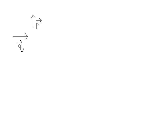

2.Draw a sketch to find each of the following graphically. (P and Q are in the attachment)
a. P+Q
b. P-3Q
c. -4P+4Q
On this one, my friend told me just to basically draw a triangle for each one of the problems, and the added third line to complete the triangle would equal the resultant vector. Is this right?

Second, yes that would work. Make sure you've got the direction arrows right though.

see attachment for b)
