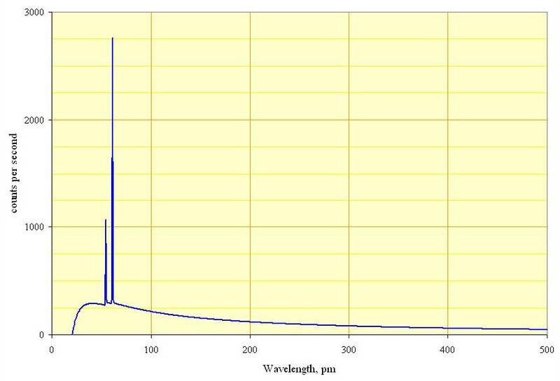

In addition to the X-rays produced by electrons falling into inner orbitals as Astronuc discussed, when a beam of high-energy electrons impacts a solid target, X-rays are also produced by a process called bremsstrahlung. Bremsstrahlung is German for "braking radiation". Since accelerated charges radiate electromagnetic waves, an electron which is decelerating as it hits a target emits radiation. If the electron's energy is high enough, this radiation will be in the form of X-rays.
I think most of the X-rays in a medical X-ray machine are produced through bremsstrahlung, rather than line emission due to electrons falling into inner shells. I'm not certain of this, however.
The picture below is from the wiki article on X-Rays.
Spectrum of the X-rays emitted by an X-ray tube with a rhodium target, operated at 60 kV. The smooth, continuous curve is due to bremsstrahlung, and the spikes are characteristic K lines for rhodium atoms.
