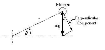

Angular acceleration = Torque/Inertia
Torque = Fd
Mass_moment_Inertia=mr^2
->assume masses on the end of seesaw are point particles for calculating inertia. is this the correct thing to do?
->is this formula for angular acceleration fine for the instant at release?
I=mr^2
I=m[d-a]^2-ma^2
I=m[(d-a)^2 - a^2]
Torque = Fd
Torque = mg[(d-a)-a]
Angular acceleration= Torque/Inertia
[(d-a)-a]mg/[(d-a)^2 - a^2]m ---->cancel m from top and bottom
=g/(d-2a) ---->canceled (d-a)-a from the top and bottom (because equivalent to rg/r^2)
I think my maths at the end might be dodgy, maybe my assumptions are incorrect too.
Thanks in advance for your help!
Edit: Or should I somehow be using the equations of motion for this one? I can't see how though :'(

You should write the expression for torque as a function of theta.
So...
I=m(d-a)^2+m(a)^2?
Torque=d*F*sin(theta)
angular accel=Torque/I
m*g*sin(theta)*((d-a)-a)/m(d-a)^2+m(a)^2
angular accel=g*sin(theta)*((d-a)-a)/(d-a)^2+a^2 ------>factorised denominator, got rid of m
Is this any better? Is that the expression for Torque required?
Torque=d*F*sin(theta) when theta is the angle between the force vector and the radius vector (rotation arm). In this case the angle θ as shown in the diagram is not this angle.
It might be better to think in terms of finding the component of the force that is perpendicular to the lever arm, multiplying that by the radius vector magnitude. In this case I think you'll find that the perpendicular components of the force are given by m*g*cos(θ).
Ahh I see thanks gneill. Yeah, the diagram illustrates your point nicely.*blushes* silly mistake.
