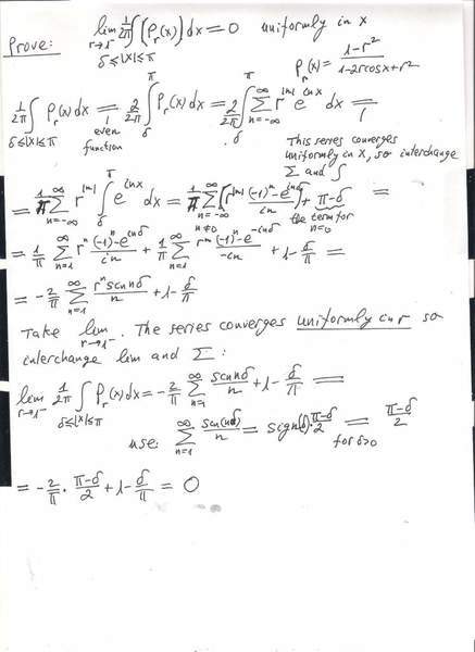

show that the integral of the poisson kernel (1-r^2)/(1-2rcos(x)+r^2) converges to 0 uniformly in x as r tend to 1 from the left ,on any closed subinterval of [-pi,pi] obtained by deleting a middle open interval (-a,a)
the integral of poisson kernel from -pi to pi is 2pi
. The attempt at a solution
:it must by a direct conclusion of the integral in 2 but somehow i fail to see it.
Is ##r## always positive? Is ##P(-r,x)## defined?
main guidelines for the proof in the attachment.
