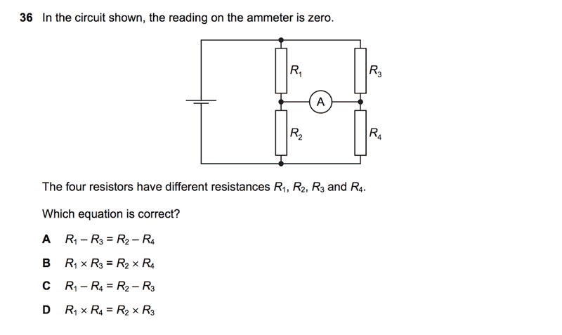

So here is a circuit question that I couldn't solve
V=IR
So I assumed that since the ammeter gives no reading it should lead to no potential difference in between those two points, then I'm completely stuck. Please help, the answer is D for reference:)

Think in terms of what is necessary, even if it is not sufficient.
(Nasty question though!)
Ok, so now you can remove the ammeter from the circuit. It won't make any difference.
So how are R1 and R2 connected? How are R3 and R4 connected?

Still have no clue man, a little more hint?
Ehh please be more specific man, thanks for the reply
Have you studied series and parallel connections? How are R1 and R2 connected?
Yea they are in series with the same current but shared voltage.
