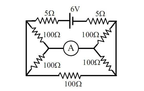

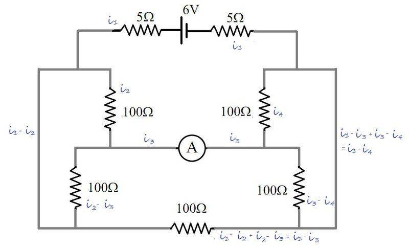

VSayantan
57
Circuit schematic with a 6V battery in the top branch, two 5Ω resistors on either side of it, four 100Ω resistors forming a bridge around a central ammeter marked A, and one 100Ω resistor along the bottom wire.
[/B]
It is required to find the current through the ammeter, marked A, in the above figure.
##V=iR##
I've redrawn the circuit as follows -
Circuit schematic with a 6V battery and two 5Ω resistors in the top branch, four 100Ω resistors forming a bridge with an ammeter A in the middle, and a 100Ω resistor along the bottom; branch currents are labelled i1, i2, i3, i4 with handwritten annotations.
But don't know how to obtain the value ##i_3##

VSayantan said:
View attachment 215842[/B]
##V=iR##
Apply loop rule
You are making this a lot harder than it is. What is the relationship between the two 100ohm resistors to the left of the ammeter?
Have you studied Thevenin's theorem?
They are connected in parallel.
So, what do you DO with that information ... ?
The equivalent resistance is ##{\frac {100} {2}}\Omega##
But most of the current will flow through the left-most path, since it has no resistance.
I don't know what to do with the ##50 \Omega## resistance.

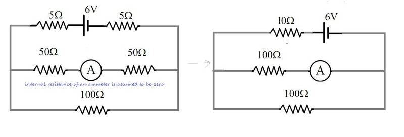

phinds said:
You REALLY want this to be hard, it seems. Try redrawing the circuit, collapsing as many resistances as possible into single resistances.
Three circuit diagrams in sequence with arrows between them: a 6V cell with 5Ω resistors and 100Ω resistors around an ammeter, reduced to a 6V cell with 50Ω resistors around an ammeter and a 100Ω resistor, then to a final loop with 50/11Ω resistors and a 100Ω resistor.
Is this the reduced circuit?
  • Three circuit diagrams in sequence with arrows between them: a 6V cell with 5Ω resistors and 100Ω resistors around an ammeter, reduced to a 6V cell with 50Ω resistors around an ammeter and a 100Ω resistor, then to a final loop with 50/11Ω resistors and a 100Ω resistor.
No, the second circuit is the reduced circuit. You can find the ammeter current using simple current division.
What is the resistance of an ammeter, if it is not mentioned in the problem?

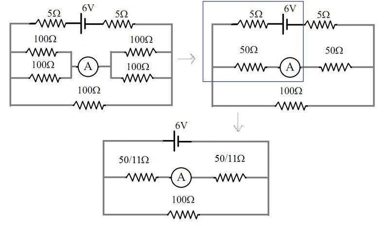

No, you are still missing a valid step (your last step was, as cnh pointed out, invalid). Think about how you could reduce it from 5 resistors to 3 without changing the flow through the ammeter.
The resistance of the ammeter is not given. So, I assume it to have zero resistance.
Four-step sequence of circuit schematics with arrows: a 6V battery circuit with 5Ω, 100Ω and 50Ω resistors and an ammeter, simplified to a single loop with 5Ω, 6V, 5Ω and 50Ω resistors.
The equivalent resistance of the last circuit is ##60\Omega##?
Then the current through the ##5\Omega## resistance is ##100 mA##
  • Four-step sequence of circuit schematics with arrows: a 6V battery circuit with 5Ω, 100Ω and 50Ω resistors and an ammeter, simplified to a single loop with 5Ω, 6V, 5Ω and 50Ω resistors.
Now you're just floundering but you got part way there. This is the circuit you need to validly simplify:
Circuit schematic with a 6V battery, two 5Ω resistors on the top branch, two 50Ω resistors in the middle branch on either side of an ammeter marked A, and a 100Ω resistor on the bottom branch. Note reads: internal resistance of an ammeter is assumed to be zero.
What is the effect on the current through the ammeter if you move the 5 ohm resistor together and the 50 ohm resistors together?
  • Circuit schematic with a 6V battery, two 5Ω resistors on the top branch, two 50Ω resistors in the middle branch on either side of an ammeter marked A, and a 100Ω resistor on the bottom branch. Note reads: internal resistance of an ammeter is assumed to be zero.

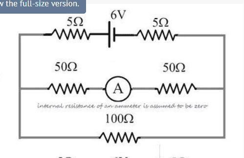

Two circuit diagrams side by side: the left has a 5Ω, 6V battery, and 5Ω in series on the top branch, and parallel branches of 50Ω, an ammeter A, 50Ω, and 100Ω; the right has 10Ω and a 6V battery on top, with 100Ω, ammeter A, and 100Ω in parallel below, with an arrow between them.
Like this?
Then the potential is same because the resistors are all connected in parallel. Right?
  • Two circuit diagrams side by side: the left has a 5Ω, 6V battery, and 5Ω in series on the top branch, and parallel branches of 50Ω, an ammeter A, 50Ω, and 100Ω; the right has 10Ω and a 6V battery on top, with 100Ω, ammeter A, and 100Ω in parallel below, with an arrow between them.
VSayantan said:
Like this?
Correct, but not ALL resistances are in parallel. Now what is the current through the ammeter? You already know the current through the 10 ohm resistance. How will it split between the two parallel branches?

cnh1995 said:
Correct. Now what is the current through the ammeter? You already know the current through the 10 ohm resistance. How will it split between the two parallel branches?
The current through the ##10~ohm## resistance is ##100~mA##.
So, the potential across the ##10~ohm## resistance is ##1.0~V##.
Therefore the potential across the parallel branches must be ##5.0~V##.
Since the ##100~ohm## resistance, connected with the ammeter, is made of two equal resistances the potential is equally divided, but same current flows through each component. Giving a value of ##\frac {5.0~V} {100~\Omega}##, i.e., ##50.0~mA##
.Scott said:
I don't think he knows the current through the 10 ohm yet.
He does. See #15.
Looks good.
