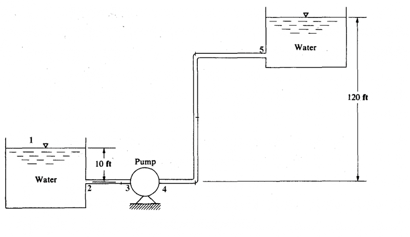

I have a doubt on the use of Bernoulli equation for pumps. Consider the situation in the picture.
Diagram of a pumping system: a water tank on the left with its surface at point 1 and outlet at point 2, a pump between points 3 and 4, and a pipe rising to a higher tank entering at point 5. Labels show 10 ft and 120 ft height differences.
I marked different points: ##1## on the surface of first tank, ##2## in the exit from first tank, ##3## just before the pump, ##4## just after the pump and ##5## entering the second tank.
Now consider Bernoulli equation in the "normal form" (ignoring the pump)
$$p_a+\frac{1}{2} \rho v_a^2 +\rho g h_a=p_b +\frac{1}{2} \rho v_b^2 +\rho g h_b\tag{1}$$
And in the form for the presence of pump delivering power ##\mathscr{P}##
$$(p_a+\frac{1}{2} \rho v_a^2 +\rho g h_a) Q +\mathscr{P}=(p_b +\frac{1}{2} \rho v_b^2 +\rho g h_b) Q \tag{2}$$
##a## and ##b## are two generic points among the ones listed above.
My question now is: can I use ##(2)## between any point before the pump and any point after the pump, regardless the height, velocity and pressure in such points?
I have this doubt because usually one takes point ##1## and ##5## and uses ##(2)## - and I'm ok with that- but, if the answer to previous question is yes, I could also choose to use ##(2)## between ##1## and ##4## or ##2## and ##5## or ##2## and ##3## and so on and that sound strange because the quantity ##p+\frac{1}{2} \rho v^2 +\rho g h## should be the same before and after the pump, indipendently from the particular point chosen. In other words I should be able to use ##(1)##, normal Bernoulli equation, between ##1## and ##2##, which is not very realistic, since the fluid in ##2## will probably move with a velocity that is influenced by the pump.
That is, even if ##2## is before the pump, the velocity there is different from the situation with no pump. And that's what I cannot understand here. How is that possible? And can I use ##(1)## between ##1## and ##2##?
Any suggestion is highly appreciated.
There is one slight problem. friction.If your system was frictionless and point a is before trhe pump and b is after it, I suspect the equation would be correct.
(for any points a and b which satisfy these conditions)
But because of the friction there is going to be more (whatever the units are called) "upstream" in your equation.
The specific energy at 4 will be higher than the specific energy at 5.(ignoring heat)
Adding a friction term into the equation would probably fix that.

Yes, the fluid will move at ##(2)## because of the pump, but the pressure will also drop (according to ##(1)##).
Think about it: If the static pressure would remain the same, how would the fluid from the tank accelerate into the pipe to gain speed? ##ma = \Delta F = \Delta PA##
Assuming no losses from the pipes, the standard Bernoulli equation can be used before or after the pump, just not across the pump.

A positive displacement pump working steady state can be modeled as a flow sink on the inlet side and a flow source on the delivery side .
Gets a bit more complicated for rotodynamic pumps .

The pump only performs work on the fluid within the pump. The pressure increase (sometimes called a pressure jump) times the volume flow rate equals the output power of the pump.

Why do you think a turbine-like pump performs work on the fluid before its entrance? Is it because the fluid speeds up? Because the energy to accelerate the fluid comes from its static pressure which decreases as the speed increases. The result is no added energy to the fluid. Just like as if it was a convergent nozzle.
The energy begins to increase when the fluid enters the first rotor-stator assembly.

Within the pump there's a pressure gradient, in this case increasing from the inlet to the outlet. It doesn't matter where in the internals of the pump that the pressure increases, only that the pump maintains a pressure difference between the inlet port and the outlet port.
Since mass flow is constant within the pump, and assuming no compression (no change in density), and that the inlet and outlet ports are the same size, then the volume flow through the pump is constant and only the pressure increases.

At start up, there is acceleration of flow, but once the flow reaches steady state, then there's no net acceleration of fluid by the pump (flow rate out = flow rate in, assuming no change in density), just an increase in pressure.
