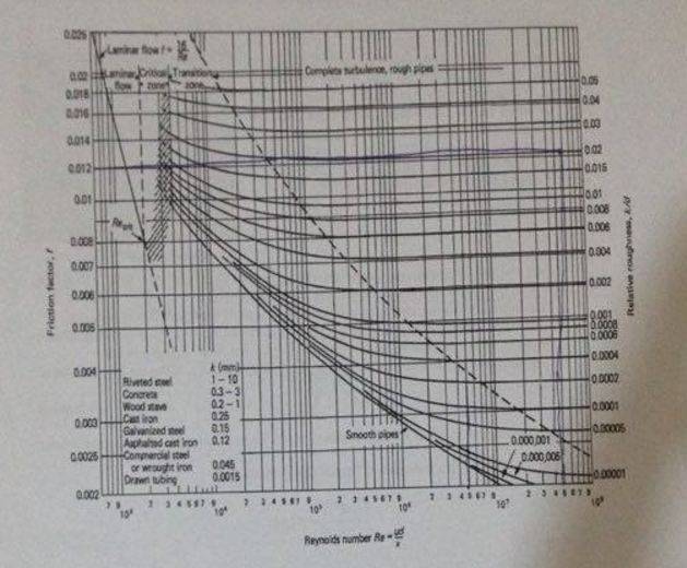

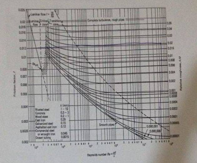

ii)f=?fanning friction
##ξ=\frac k D## =##ξ=\frac {0.0002} {10^-1}##
ξ=2*10-3
=> f=0.006 from ξ∩Re on Moody Chart

##ξ=\frac{k} {D}=2*10^{-3}##=0.002
ξ∩Re=>f=0.006 from Moody Chart
