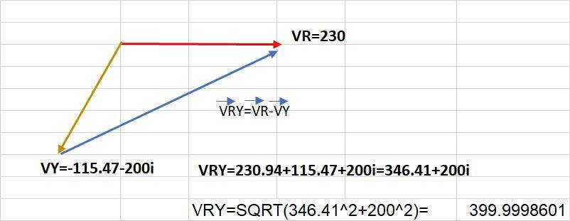

According to vectorial diagram:
  • Phasor diagram on a grid: red arrow labelled VR=230, gold arrow labelled VY=-115.47-200i, blue arrow for VRY=VR-VY, with calculation lines VRY=230.94+115.47+200i=346.41+200i and VRY=SQRT(346.41^2+200^2)=399.9998601.
Thanks - I see you’ve ignored the (-) sign when adding the vectors. I assumed that if the voltage magnitudes are of opposite sign they subtract. Is that not correct?
Phasors point from the origin, neutral or ground.
The Line to Line voltage is therefore not the sum, it is the voltage difference.
