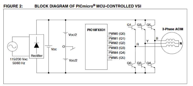

Here's an appnote written for people who are more skilled in the craft than i .
http://ww1.microchip.com/downloads/en/AppNotes/00955a.pdf
At first glance it appears to me
the "space vector" is generated by adding together unequal portions of the three individual phase-to-neutral voltages
which could be what your gyrating circle linked in first post represents. Is that why the red green and blue arrows have varying lengths ?
They then go on to describe PWM'ing each phase , which is i suppose how they vary the voltage applied to each winding.

Thanks guys. I am going to build a brushless DC(BLDC) and a permanent magnet synchronous motor(PMSM). The BLDC is easy to control, but I have been having a really tough time finding information on easily controlling a PMSM.
I found a textbook on space vector control, but they expected you to know how the space vector works as a prerequisite. I traced back about 10 articles references until I found the method of synchronous components. I think its a good intro to understanding space vectors. Cant find any good practice problems for line to line faults (which is what the method is really for) but I found a decent course on MIT OCW http://ocw.mit.edu/courses/electric...-electric-power-systems-spring-2011/index.htm
If anyone knows an easier way to control a PMSM that would help to. I can move forward and take my time with this Space Vector control. Otherwise ill be studying this for a while because I am stubborn :-/

Just looking at that Microchip i can sort of see what they're up to in figure 2, PWM'ing Q0 thru Q5 to make three variable voltages that are applied to coils spaced 120 degrees apart. Express in rectangular coordinates of your choice, X-Y , D-Q, rotor or stator, and add.
Am i on right track ?
But I'm a long way off from Clark transforms and field oriented control...

Finally figured it out. The original phases are put on an axis of the motor because the coils physically are ##120^\circ## apart. Then you take the 3 phase current waveform of the coils and using Parke and Clarke transforms you put the waveform on the rotating axis of the rotor to give you a space vector. The current space vector for max torque has to be ##90^\circ## ahead of the rotor flux. The Parke transform gives you a D and Q axis, the D axis will be the rotor axis. So since you want your signal ##90^\circ## ahead, you ignore the D axis and put max current on the Q axis.
Then you take your waveforms, use inverse Clarke and Parke transforms, use a pi controller to give a Va, Vb, Vc for each phase. The better term to google is not space vector control, its field oriented control.
