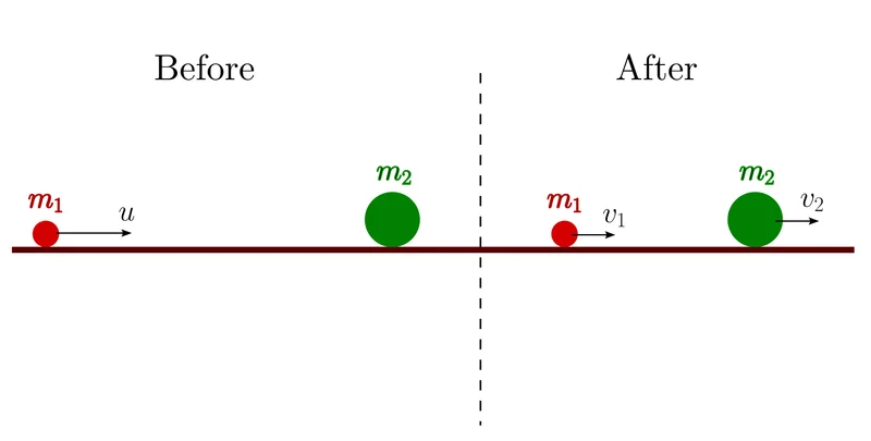

(The symmetry argument) : The particle of mass ##m_1## moving with velocity ##u## to the right relative to particle of mass ##m_2## is the same as the latter moving with velocity ##-u## to the left relative to the first. But the second particle has a different mass ##m_2##. The two situations are not symmetric before collision, hence the final velocities will also not be following collision.
(The mathematics) : From the picture drawn for the problem, momentum conservation yields ##\small{m_1 u=m_1v_1+m_2v_2\Rightarrow v_2=\dfrac{m_1}{m_2}(u-v_1)\quad\color{blue}{\dots 1}}##. From energy conservation : ##\small{m_1 u^2=m_1v_1^2+m_2v_2^2=m_1v_1^2+\dfrac{m_1^2}{m_2^2}(u-v_1)^2\Rightarrow u^2=v_1^2+\dfrac{m_1}{m_2}(u-v_1)^2\Rightarrow \left(1+\dfrac{m_1}{m_2}\right)v_1^2-\dfrac{2m_1u}{m_2}v_1-u^2\left(1-\dfrac{m_1}{m_2}\right)=0}##, which can be solved to give :
##\small{v_1=\dfrac{\dfrac{2m_1u}{m_2}\pm\sqrt{\dfrac{4m_1^2u^2}{m_2^2}+4u^2\left( 1- \dfrac{m_1^2}{m_2^2}u^2\right)}}{2\left(1+\dfrac{m_1}{m_2}\right)}=\dfrac{\dfrac{m_1}{m_2}u\pm u}{1+\dfrac{m_1}{m_2}}=u\;,\; \dfrac{\dfrac{m_1}{m_2}-1}{\dfrac{m_1}{m_2}+1}u}##.
So the final velocity of the first particle can be ##\boxed{(v_1=)\,u}##. Using ##\small{\color{blue}{1}, \boxed{v_2=0}}##, the final velocity of the second particle. If I am correct, then indeed no symmetry exists in the final velocities.
Or if the final velocity of the first particle ##\small{\boxed{(v_1=)\,\dfrac{\dfrac{m_1}{m_2}-1}{\dfrac{m_1}{m_2}+1}u}}\Rightarrow \boxed{v_2}=\dfrac{m_1}{m_2}u\left(1-\dfrac{\dfrac{m_1}{m_2}-1}{\dfrac{m_1}{m_2}+1}\right)=\dfrac{m_1}{m_2}u\dfrac{2}{1+\dfrac{m_1}{m_2}}=\boxed{\dfrac{m_1}{m_2}\dfrac{2u}{1+\dfrac{m_1}{m_2}}=v_2}##, which is the final velocity of the second particle, again showing no symmetry exists.
Request : Am I correct in my arguments above?
