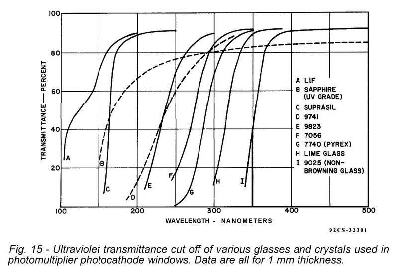

I've hit a dead end with an experiment and could use some additional perspective. I'm in need of material for a 100 mL round boiling flask that has good transparency down to about 140 -180 nm. I originally considered Type 214 Fused Quartz, but I need a material that will not fluoresce. Pyrex won't fluoresce, but it's only transparent down to about 340 nm. I also cannot afford to purchase the material in bulk, meaning it will likely have to be a material someone has in stock and not made to order.
Essentially, I need a material...
  • Transparent down to ~140 nm
  • Non-fluorescing
  • Small quantity
Any ideas for a material (and/or supplier)?
Thank you in advance.

I imagine a sapphire meniscus lens, as a window, fitted in the wall of a spherical flask. Ground and polished from sapphire, with the concave inner surface having the same radius as the inside of the spherical flask. That will interfere least with an internal acoustic resonance.
The convex outer curvature might help to focus UV from the spherical flask centre into an external optical system. The bigger the window/lens the more UV will be captured.
If a second sapphire lens, (with positive curvature), is needed to get a focus outside the flask window, some water from inside the flask, between the two sapphire lenses, might help.

I see no reason why the flask manufacturer needs to be involved. You can cut a hole in a Pyrex flask with abrasive paste on a tubular trepan cutter. Fit a circular sapphire lens/window into the hole. Seal it with something chemically compatible, maybe silicon rubber, hot melt glue or a flexible epoxy.
What material is used for the window of your PM tube?
You might just glue the PM tube into the hole you cut in the flask.
Alternatively, a dead UV PM tube would provide a low cost UV window.
Attached is an extract from page 18 of the "Photomultiplier Handbook", Burle.

We're using a monochromator infront of the photomultiplier, so attaching the PM itself to the flask wouldn't work out. I love the idea of fitting a lens into the flask as a window (dead PM tube lens is a good idea, but probably need something to fit the flask curvature)... I'll put it past some acoustics people and see whether it'll work out.
