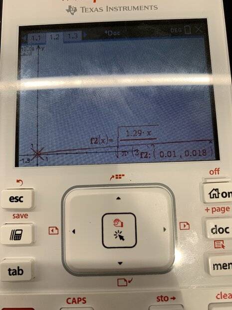

##\sqrt{\frac{\nu t_0}{\pi R^2}} = sqrt((1.29*0.01)/(pi*0.035^2)) = 1.83##. Any idea why this is the case (this is the calculation for water)? Also, for how you expressed the change in angular velocity over time in post #51, is there a source for this formula or is this from your own knowledge (the part before deriving the solution based on dimensionless parameters)? Would it be fair to say that I can omit the asymptotic solution and the solution of the dimensionless parameters from the investigation because an in-depth discussion into the viscosity boundary conditions and the parameters used to find the time taken to roll down the ramp should be sufficient based on my personal judgement, no? The only thing I would include perhaps is the derivation using the dimensionless parameters in the appendix so that I can refer to it in the theoretical background when I refer to how the long-time formula is:
##t=t_0*sqrt(3/2)##
Since the graphs I will include in the investigation will be based on the viscosity boundary conditions parameters that is what I based my personal judgement out of as to not let the theoretical background be too tedious for the examiner.
In that case, then is there a way that you derived the sqrt3/2 out of the dimensionless parameters because that it isn't explicitly mentioned how. I'm thinking of doing the experiment again today with more data points as it seems that the calculations aren't adding up, maybe they'll come out closer this time to the expression we have to calculate the time. I graphed the parameter as a function and you can see it here: https://www.desmos.com/calculator/fvlmni6hev
the calculations under the function and set hor. asymptotes and from top to bottom the fluids are: water, oil, honey, transmission fluid and as you can see the results are nonsensical. I'm not quite sure why this is happening (I am sure the calculations for the kinematic viscosity is correct as it is the viscosity in poise divided by the density of the liquid, maybe there is an issue in the densities? the numbers are ridiculously high
  • #104
Yes. The units are screwed up. It should be 0.0183. The R should be 3.5, not 0.035. We are working with cgs.

  • #105
See Bird, Stewart, and Lightfoot, Transport Phenomena, Appendices
This is a judgment call on your part. However, the derivation of the asymptotic solution is new, and has never appeared in the literature before. This would be a major contribution to the understanding and to the solution to this problem. You can take credit for it if you want. I don't care about being acknowledged.
The theoretical development can be relegated to the Appendix. You can take credit for marshaling the resources to get the theoretical development implemented.
I don't follow. I thought I did this.
I can't read the graph. t/to should be y, and the other dimensionless group should be x. Do you not have access to Microsoft Excel? In terms of these x and y parameters, the short term solution should be a straight line. ##y=(1+\frac{16}{15}x)##
Like I said, the 0.035 should be 3.5.
I redid the calculations then and the range of values is 0.0183-0.2087. Also, I was graphing the parameter for ##t=\sqrt{\frac{\nu t_0}{\pi R^2}}## not ##t=t_0\left(1+\frac{16}{15}\frac{\nu t_0}{\sqrt{\pi R^2}}\right)##. In regards to the dimensionless parameters, I read it quite a few times to determine where the sqrt(3/2) came from but it was never explicitly stated in the post, I may have misunderstood it though or maybe it was inferred piece of information?

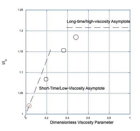

If you are plotting the data points, then in t/to, you put the actual measured time down the ramp for t, and the inviscid time 1.29 sec, for to.
The plot should crudely look something like this:

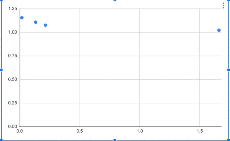

Using the values of kinematic viscosities of
0.01 (water)
0.53 (sunflower oil)
82.75 (molasses honey)
1.37 (transmission fluid)
Based on these values, I got these data points for the liquids in the same order:
1.1550.018
1.1080.133
1.0231.66
1.0770.214
I cannot make any sense of these numbers as they are nowhere near the boundaries (1.29 to 1.57). The graph looks like this (only the points attached below). Why do you think that the graph looks like this? I am using the value of 3.5 cm as the radius and the others are constant values.

I've been tweaking the numbers for some time now and I've come to the conclusion that even if the values for kinematic viscosity were such that we get the expected value from the boundary condition parameter, its values would not make sense theoretically based on the actual liquid. Is there something we're missing?
  • #114
Let’s see your graph.
  • #115
This graph shows the viscosity boundary condition parameter where the kinematic viscosity is x in order to show the general shape of the curve. I've highlighted the first data point where x (kinematic viscosity) is 0.01 and you can see that the value is 0.018 which does not make sense in the context of the experiment.
  • #116
I can't see a thing from your photo.. Print it out and then take the photo.
  • #117
This is a scatterplot of what we find when graphing t/t_0 against the viscosity boundary condition parameter with data points that I have outlined in post #109. As you can see, there is little meaning attached to these data points as they are outside of the boundary conditions set. I have made sure to keep the radius in centimeters although it doesn't change much if it is in meters as the results still do not add up. I can add the asymptotes for the time into this graph, but it is surpassing it from both the minimum and maximum so it would not add anything.
  • #118
This doesn't make any sense to me. Please make me a table of the times vs the kinematic viscosities. Previously, in your experiments, the shortest time was water and the longer times were the more viscous fluids.
