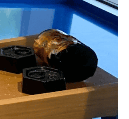

I am currently [in the process of] working on a physics report that investigates the effects of changing the fluid (and thereby the density) within a cylindrical shell on rotational motion, specifically focusing on the time it takes for an object to reach the bottom of a ramp when placed in this cylindrical shell. I would greatly appreciate your assistance and feedback to ensure that my research and report are comprehensive, coherent, and well-structured.
Equations for acceleration and velocity were derived for the particular situation with the fully solid cylinder
I am not sure if my report is complex enough as it should be at the undergraduate level preferably based on the requirements for it and it feels like it's all over the place as of now.

Looked at your document briefly and spotted various issues.
The topic and approach (as they currently stand) are high-school level, not university undergraduate level. You should try to look at one or more exemplar reports to better understand the level/standard you need to aim for. Ask your supervisor.
The topic claims to be about ‘inviscid’ liquids; that means ones with negligible viscosity. But substances such as honey have large viscosities. So it doesn’t make sense.
You initially state the research question is about how the type of liquid affects the results. Later on, you change this to how the amount of liquid affects the results. You need to be absolutely clear and consistent about what you are investigating. (Note, if by ‘amount’ you mean volume, then it appears that the ‘amount’ is in fact constant for all your measurements.)
There appear to be many mistakes ranging from the minor to the serious. For example:
- you state that you used 549kg of honey (Table 4) when you probably means 549g;
- you state that the length of your ramp was 145m (table 6) when you probably mean 145cm;
- sometimes units have been completely forgotten (e.g. Table 4 column 3);
- you state “...the gravitational force component remains the same across all experiments”. But that’s wrong because the containers of different liquids have different weights.
These are just some of the items I picked up with a quick read-through. It appears that you have not carefully/critically checked your own work. You must not rely on others to do this for you.
A minor point: you swap between using the terms ‘liquid’ and ‘fluid’. ‘Fluid’ means liquid or gas; make sure you are using the appropriat term.

The outside diameter was 7 cm while the inside diameter was approximately 5.5 cm
That would mean the wall-thickness of the can was over 7mm. The photo' in your report shows what seems to be a food can (though it's not clear); if so, the wall thickness should be much less than 7mm.
Edit: Maybe 7mm is the thickness of the can's corrugations, not the thickness of the sheet material.
Oh, I see what you mean. It's a standard food can with a thickness of 0.15mm
Did you conduct the experiment with it in the state shown...with paper folds and electrical tape all over the can?
I was in a bit of a rush that day, but no that was just an initial position photo. Afterwards I removed the paper folds and made the duct tape covering better and less haphazard (as you can see it was dripping so i also cleaned the ramp so that there wouldn't be any effects on the friction) before I conducted the experiment to measure the time it took to reach the bottom of the ramp
