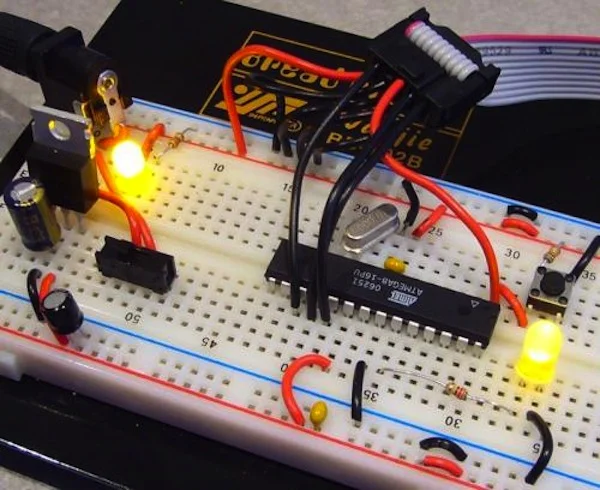

Wait, is this a soldered PCB connection, or a spring-loaded breadboard connection? As already mentioned, some pictures would help. Also, if these are power resistors, the leads may be too large for a simple plug-in breadboard...
https://learn.sparkfun.com/tutorials/how-to-use-a-breadboard/why-use-breadboards

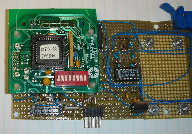

I think you're just learning why I hardly ever used those things for my breadboards. Plus, they aren't stable or durable. Basically, I hate those things for wasting my time. It doesn't take long to solder after you place components.
Anyway, I'm not sure what to add, except that dealing with instrumentation issues is part of an EE's life. They all have issues at some point. It's your job to understand your measurements/instruments, not just to collect data blindly.
