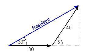

Two forces of 30N and 40N act on a particle such that the resultant vector makes an angle of 30 degrees with the first vector. What is the angle between the given vectors and magnitude of the resultant vector?
I know of vector addition, but i can't find out the angle between the vectors in this one, if i know the angle, i can figure out the rest.
Thank you.
Perhaps a diagram will help?
Yes i figured out the diagram myself but i still can't find the value of [tex]\theta[/tex] .
